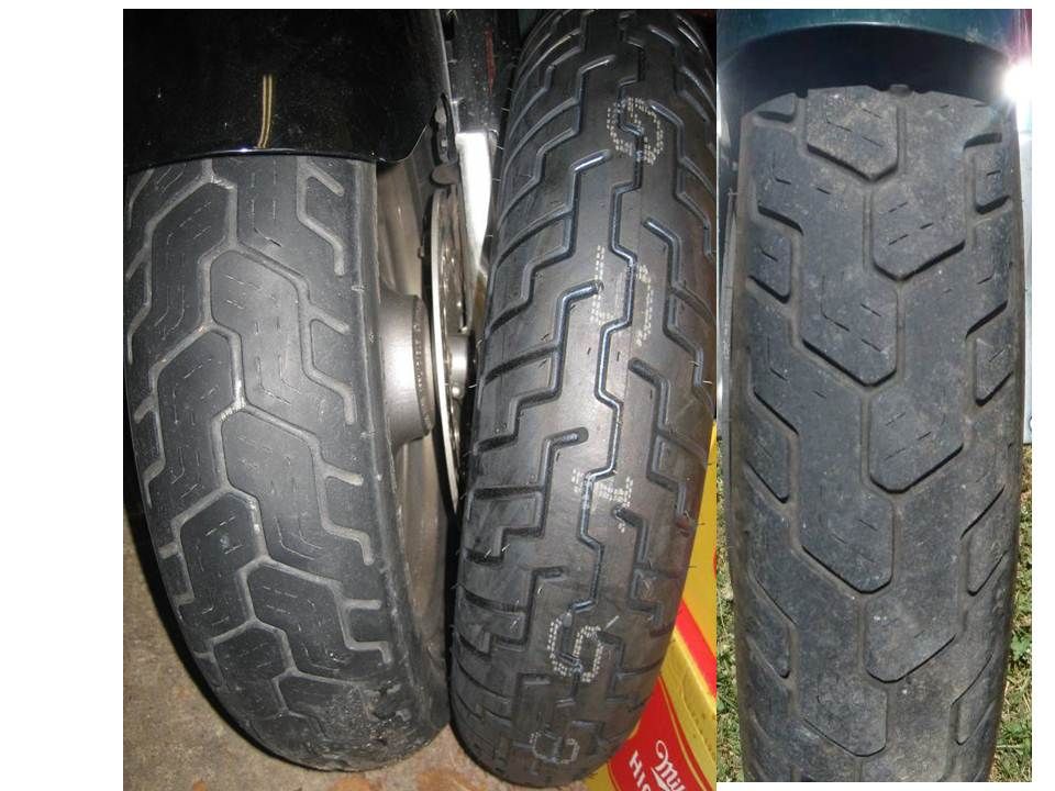

« Reply #13 on: July 25, 2014, 08:25:17 AM »
Gryphon Rider provided this explanation last year:
With directional tread patterns and rain, if the tire's contact patch is not moving faster or slower than the road surface (i.e. the tire is not sliding due to acceleration or braking forces), the direction of the "V" has no bearing on how well it evacuates water.  Water is simply squished out from under the tread blocks and into the nearest groove with capacity to take it.  When the back tire is slipping due to acceleration, the "V" should point towards the back of the bike at the road surface.  It acts the same as a tractor tire slipping in mud, directing the fluid towards either side of the tire, rather than scooping it towards the centre of the tire.  When the front tire is slipping due to braking forces, the "V" should point towards the front of the bike at the road surface.  It acts like a "V"-shaped snow plow, pushing the fluid towards the sides, rather than scooping it towards the middle.
See entire post HERE.
That made sense to me.  In the photo collage below, the tire in the center is a front tire as designed by Dunlop.  Knowing that the center tire is correct, it puzzles me how the tire on the left must be wrong while the tire on the right is correct.
Also, if the tire on the right is correct and maximizes water dispersion, it presents a compelling argument for mounting a front tire on the front in the reverse direction.
