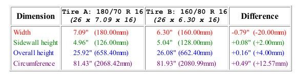

The OEM size is 180/70R16.  A 160/80B16 would be slightly taller, but not as wide.  Here are the comparison numbers:
Personally, I would ignore unsubstantiated comments of too short, too tall, too wide, too small.  However, John Schmidt raises a valid point regarding the age of the tire, although not responsive to your question.
