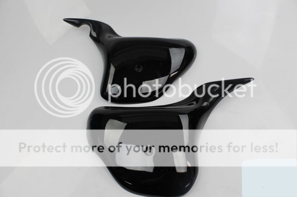

I just got a set of Corbin sidecovers, and there is no mounting kit with them. Last year at the Dam Ride, working on Roberts valkyrie (2-tones valk), his mounting looked like a regular bolt but had spacers and such. A close up picture sure would help with rigging something on my own. TIA

Terry, here are the Corbin Beetle bag/side cover install notes. (side covers are covered in page two, parts list page one) (not much detail, but should be some help)

Thanks Jess, I searched the internet and never found anything. That looks just like what Robert had on his. that will get it done.

Mine has a bushing about 2" long that has threads in it. The screw then threads through the bushing and sticks out of bushing enough for sidecover,washer and a nut to hold it on.
That way the nut, washer and sidecover come off and everything else stays put.
