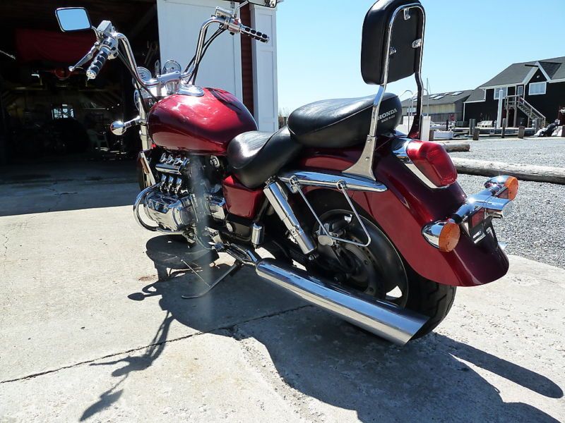

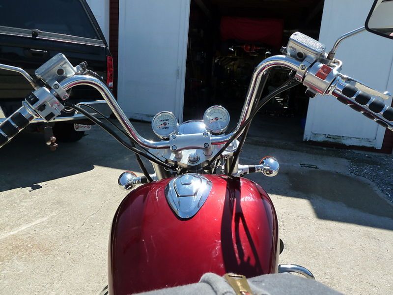

« Reply #9 on: August 18, 2014, 03:45:29 PM »
How about pictures ? Anyone have any pics of valks with apes?
IMHO, I don't think they look right on a Valk....but to each their own.
Here's two different Valks with apes....
If you only need a little bit more rise, you could do higher risers like what Jess linked to...or you could try a set of riser extentions......like these....

« Reply #11 on: August 18, 2014, 06:57:25 PM »
I have 14s on my road king and I am just use to having them there. More pics would be much appreciated if anyone has em.
By the way. BF, your bike is tricking awesome cooldude
Thanks for the complement.   cooldude  It used to be a Red & White standard before I gave it a makeover.
I didn't much like the bars either when I first bought it, but I losened the mounts and turned them up some.  Works much better for me.
Although turning the bars more upward helped alot, I'd still like for them to be about an inch higher.
I bought a set of those 1" riser adapters that I linked to on eBay earlier this summer, but cancer, a month long hospital stay and a recovery period have gotten in the way of me installing them.  I'll get to them soon though.   cooldude
btw.....That 2nd pic of that black Valk is a local bike that I've seen several times before.  I don't know what size his apes are, but on that Valk, they just don't look right IMHO.  They're too much for it.
