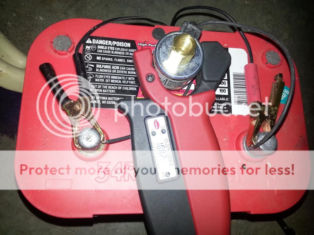

It consumes about 15 watts of power. Over time it will get hot. The cool fuel moving through the valve will help to cool it a bit, but the hot engine area will add to its temperature. After about 20 minutes mine reached almost 190 F and was still climbing.This will definitely burn you but is entirely normal for the valve.

WOW! 190°F Shocked

Ok thanks. Thinking about it more it does make sense that current is flowing to keep it open which generates the heat. Thanks for the help BonS.

Yikes!  That is kinda spooky considering gasoline is constantly running through it.
