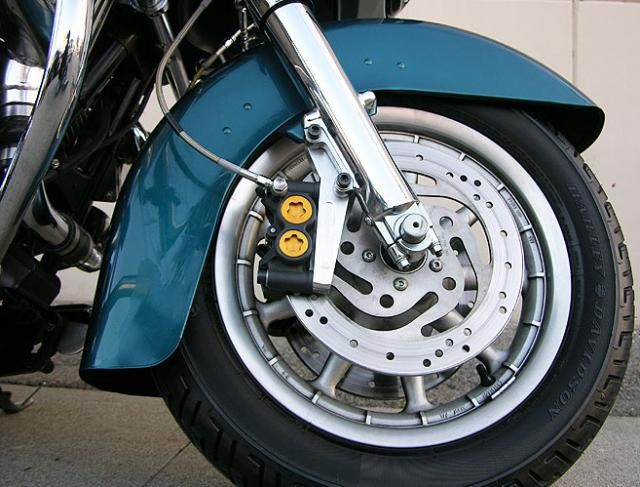

I've done a search on here for brake upgrades and I've only really found the usual braided lines / pads / Dot 4-5.5 / etc information. Or, those really expensive English Billet calipers. Beautiful, but so expensive.
The relatively recent arrival of OEM Brembo calipers on Suzuki GSXRs (and therefore their availability on eBay) and the below picture I found of a radial caliper conversion on a Harley has me wondering if if would be a possible upgrade for a FatLady?
Personally, I couldn't put those Yamaha calipers on my Valk though. It just wouldn't be right. You could use calipers of a CBR1000RR (at least they'd be off another Honda) but when Brembos are readily available, why would you use anything else?
Not sure about a suitable master cylinder. Maybe off a Honda VTX1800, I think they have a linked brake system which makes me think the piston in the MC would be bigger since it needs to move more fluid? Just thinking out aloud here, but I think I've been inspired to give it a go... once funds permit.

Because Valkyrie calipers only have two pistons per caliper. And the Brembos have 4 pistons per caliper. Assuming the pistons are (approximately) the same size, then my logic says you'd need a master cylinder with a larger diameter piston to displace an appropriate volume of brake fluid.
Usually the four piston units like that have nearly the same overall area(they're often slightly smaller) as the larger two piston unit. Check that before deciding you need a larger capacity master cylinder. Just compute the area of a single piston and multiply by the # of pistons in the caliper. Then compare the proposed new ones to the OEM.
You do remember the formula for determining the area of a circle....right?  Wink
BobB
Posts: 1568
« Reply #6 on: August 31, 2014, 08:38:08 AM »
I plan to replace my brake lines this winter with SS, but would not dream of replacing the OEM calipers.  I have panic stopped on the Phat Girl to the point of pulling my butt out of the saddle without any right hand effort.  I usually only operate the front brake with two fingers.
That said, going to a four caliper per disk setup would not require any change in the master cylinder.  There is absolutely no volume difference in the brake system as the brakes are applied.  The pads ride 1 or 2 thousands of an inch off the disks.  It all about pressure.
