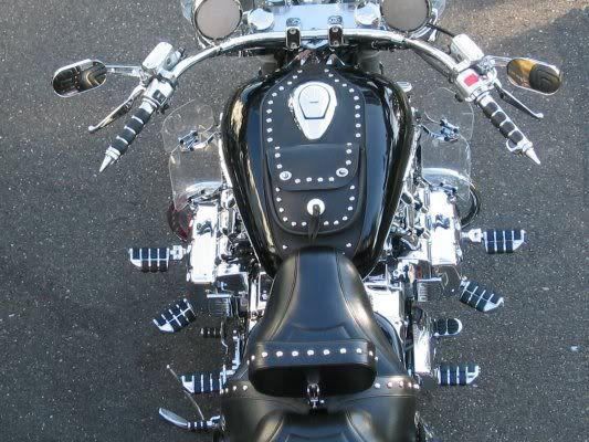

This is a photo of a Valk with bikini beach bars. The owner (don't remember who) bought bike with bars already installed so could not help me with install instructions. These bars are super cool. I would have them if I could be assured I did not have to install extra long cables. I did install them on a Yamaha Road Star and loved them.
Little photo shopping on the highway pegs. Smiley

WDAN, Sorry but, you have that pic mixed up with another members story, I know how it goes so no worries that is an old pic of my bike.  Wink  I did install those 1" Bikini Beach bars complete with 4" Lamont risers and passed the throttle cables behind the triple tree, no other mods, they work excellent and take the pinch out of the shoulders and neck area that I was getting with the stock Buckhorns.  A couple of members have asked about the install and I have passed on what I know, you must of asked someone other than myself for help because I most definitely would have helped  ......   I wanted the chubby bars as well but then the risers were a no go cuz they do not have the one piece cover plate like stock ............... Oh and  those pegs are for real ........ these on the other hand are shopped. ..............Cheers, Judd  coolsmiley
