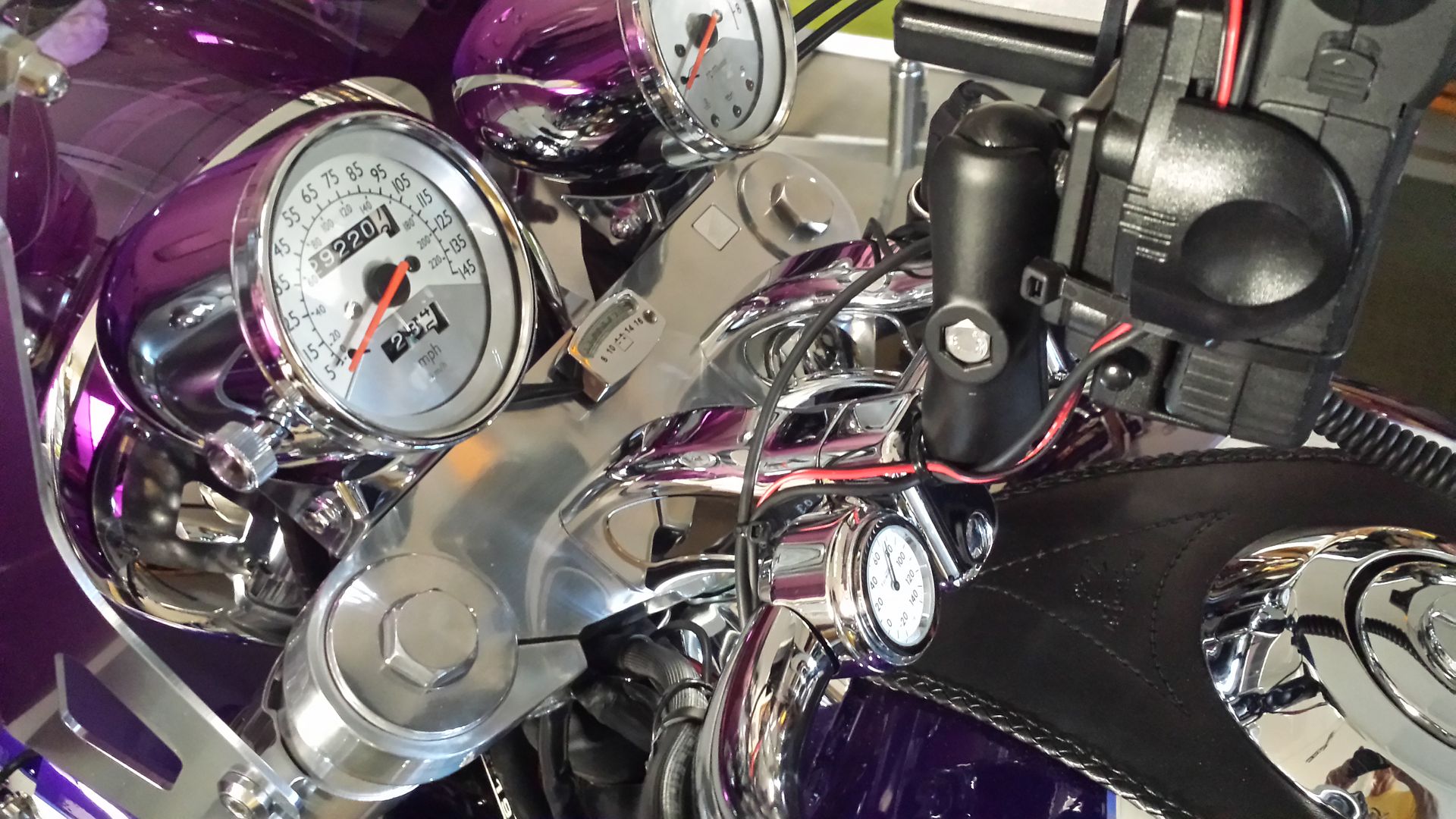

Re: Risers
September 25, 2014, 08:05:48 PM »
Here is a pic of the Phatrisers before I put the Woody back on.

Re: Risers
September 26, 2014, 05:07:22 AM »
Thanks for the pictures. I ended up on ordering the 4" Phatrisers because they were a bit cheaper and didn't raise the bars as much as the Aeromach risers do. They also give an extra .5'' of pullback which i think i will appreciate once i get them on.
