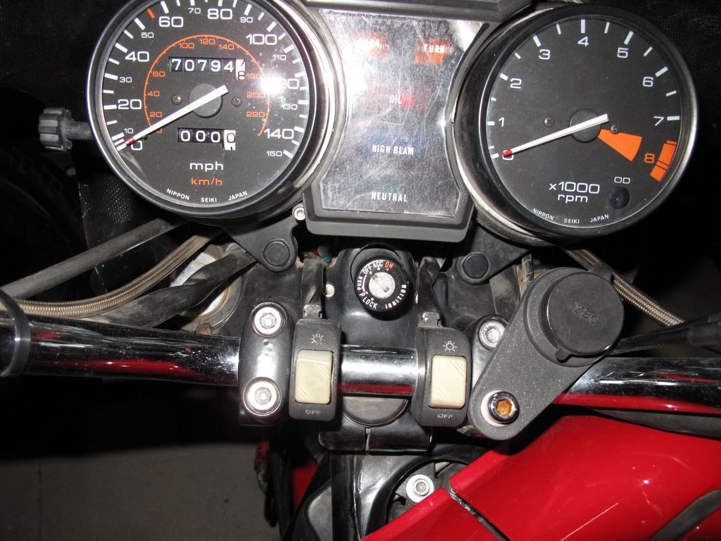

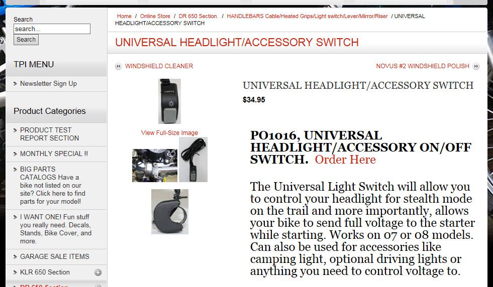

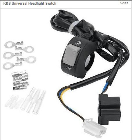

« Reply #9 on: September 25, 2014, 10:11:41 PM »
I've been using these for several years on different bikes.  5 years ago they were $20.  Now they're $35... Angry
Prolly not much current capacity, but I always use them with a relay.  TPI Motorcycle Parts was my source, but last time I saw the price increase I found them at Bike Bandit as well.  BB was still... $35, but they also include a bit more cheapo wiring components.
BB version:
TPI Version:
Here's a pick of them on my GL1200:
While they are not listed as waterproof, after being caught in the rain multiple times annually for 5 years or so, none have yet failed.
NOTE: they are only sold for 7/8" bars.  But a little dremel work to open up the plastic sides and a slight tweaking of the rear bracket lets them fit 1" bars fine.  I had them on my HD (1" bars), but when I had 4 switches I went another route.
