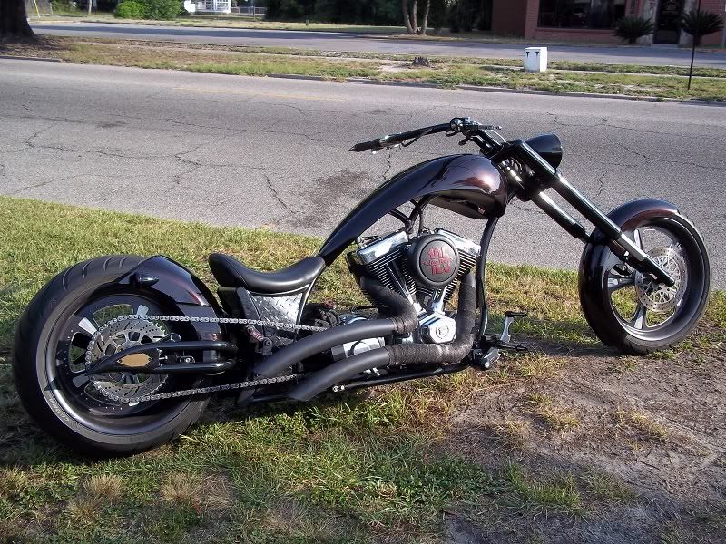

Side note:   This is the bike I used the levers on.  It's a 2008 frame I finished in 2009.  A Malibu Motorcycle Works "Super Sled" frame.  Took me a year to build it between projects.
