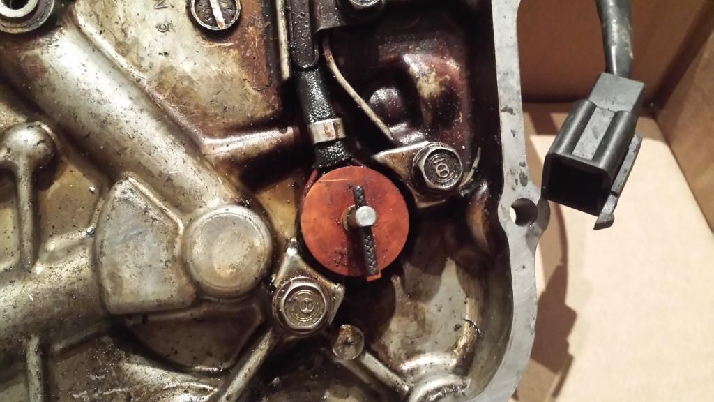

OK, I got the item from ebay.
A GW water cover (transmission cover) with the indicator switch for $10 USD. Want only the switch, so shipping should be less. Also bought some misc parts from the same seller, to combine shipping.
Now all I need is to buy a Valk to mount it to  Smiley and some kind of indicator light.

« Reply #23 on: November 19, 2014, 08:21:54 PM »
Now that the auction is over, and delivery happened, see what you can get for as little as $10 USD? They where suppose to pull and ship the switch only, but I see I got the whole tran cover.
Next step, buy a Valkyrie. Then swap the switches and wire this one in and add a light to the 5th (OD) gear indicator and mount somewhere viewable (IS fairing).

Gordonv, if and when you do this, note the pin isn't centered in that little shaft it sits in. The orientation of long end of that pin is critical so keep that in mind when making the change over. Good luck and let us know how it went. Just so you'll know, there are vendors for the Gold Wing that have a plug in gear indicator. Might want to check that out, price may be worthwhile but don't know that for sure.

« Reply #25 on: November 20, 2014, 06:38:47 PM »
Thanks John, I noticed that on pictures showing the part. Seems like 1/3-2/3 or there abouts.
I don't think the manual even says how to orientate the pin. Figure I would have the bike in neutral, swap the switches and what ever orientation the Valk was at, I would make the same for the replacement.

Honda has many different neutral switches for the GL1200/GL1500 bikes. Some have 3 wires, some have 4 or 5 wires. The GL1200A Aspencade has an actual gear indicator on the dash in addition to the neutral light. I am assuming (dangerous I know) that the neutral switch for the 1200 Aspencade has a segmented neutral switch that identifies each gear. I just ordered one from Woodbind Cycle Salvage. Interested to see if my assumption is correct. If so, this would make a gear indicator a lot easier.
This is the switch I bought

I found an online schematic (took a while) for the GL1200. Shows the switch wiring. Page 9-28
N    - light green/red
1    - yellow
2    - black/yellow
3    - white/blue
4    - red/white
OD - green/orange
The switch almost looks like it could be the same. Do you have one to compare it to?

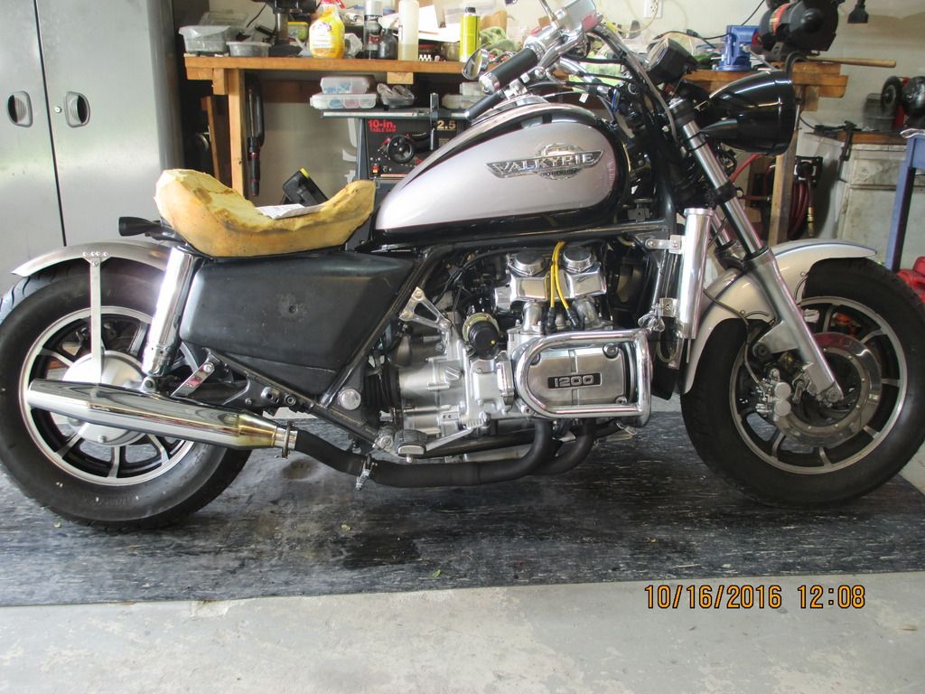

Posts: 15370
« Reply #35 on: January 29, 2017, 09:18:24 PM »
Gordon, when I changed over that switch on my 1200 project bike, the long end of that pin in your picture had to be pointed at the bolt to the lower left with the bike in neutral. There's a split shaft that fits over it and turns when you change gears. My 1200 came originally equipped without a gear indicator since it is an '84 Std.  I replaced the engine with a later year and changed that switch at the same time, easy job once everything is out of the way. I also got rid of the huge ugly OEM gauges and replaced them with a single aftermarket piece that gives me everything, including gear indication. The bike looks "somewhat" different now.  Wink
The fenders and side covers are currently removed for painting.
