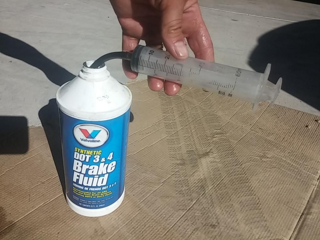

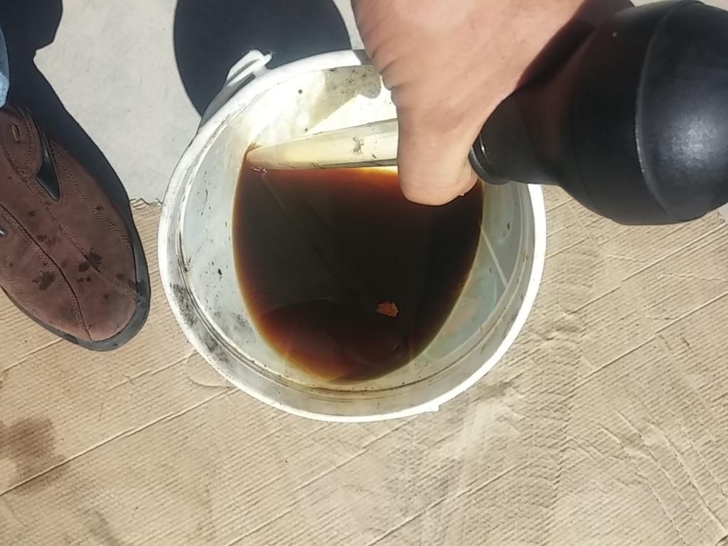

Holy dirty oil, Bat-Man!
Tins are off getting re-painted so I took the opportunity to change the 13 year old brake and clutch fluid out of the bike.. (this way you don't drip on your tins)... Now, this bike has SAT for years in a garage.. 2910 miles as of today with the original fluid.  This is what came out... YUK!
Need I say more?  Brake fluid absorbs crap just sitting.  Clutch fluid was REALLY dirty BTW.. uk.
Anyway, my brake technique is to PUSH fluid up from the bottom.  For this I use a syringe and a piece of vacuum hose.. fill with fluid, suck fluid out of the top reservoir, get air out of syringe and push fluid up.. repeat.  Much simpler than trying to drive air bubbles down.
FYI
John
2001 Valkyrie
2006 BMW K1200R
2012 Concours 14
A bunch of SAABs...
« Reply #1 on: October 05, 2014, 03:56:10 PM »
I've never heard it done like that. You put the hose on the bleed nipple and open it then squeeze in the fluid ?
jshram
Posts: 125
Cedar City, UT
« Reply #2 on: October 05, 2014, 04:01:41 PM »
Yup. Just make sure you sucked the fluid from the reservoir, or make a mess you will... Suck the reservoir dry often. I've gotten caught up in the pushing and overfilled before... Doh!
