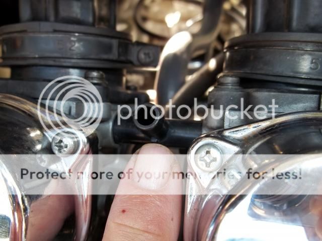

This is the connection "Tee 3 way" air rail that the gas is coming out of.....(with hose disconnected)
You can see the fuel rail line underneath (in the background).

« Reply #4 on: October 10, 2014, 02:15:43 PM »
That is the fuel rail connection..

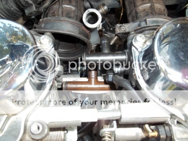

« Reply #7 on: October 10, 2014, 04:05:51 PM »
Ok, I must be missing something here.  I pulled the back bracket off without taking all the carbs off.  The two 3 ways - can only go in one way - with the fuel at the bottom and the air rail at the top.  Am I missing something here?
This puts the fuel going through the screens beneath the floats on the carbs and the air at the top.  Size wise (diameter of the 3 way connections) only allow them to go this way.  The larger of the two - the one I am calling the fuel 3 way - the odd shaped one (Brown)  that only fits on the bottom - is the only one that the fuel lines will go to (OD wise and length from the fuel 3 way that the tank feeds into).  The top one (smaller of the 3 ways - black) fits the two tubes that go to the back stay plate....and dont really connect to anything after that - the tubes just stop at the back plate.
Again, am I missing something?

Oh and for me anyway it is much easier to just take those band clamps off and leave them off until the intake tubes are on.  Then take the screw out and snake it around once everything is seated and screw them back together.  Otherwise you lose a couple into never never land on top of the engine.  I'm pretty sure that top "t" is the overflow, not looking at one at the moment but your pictures help.
