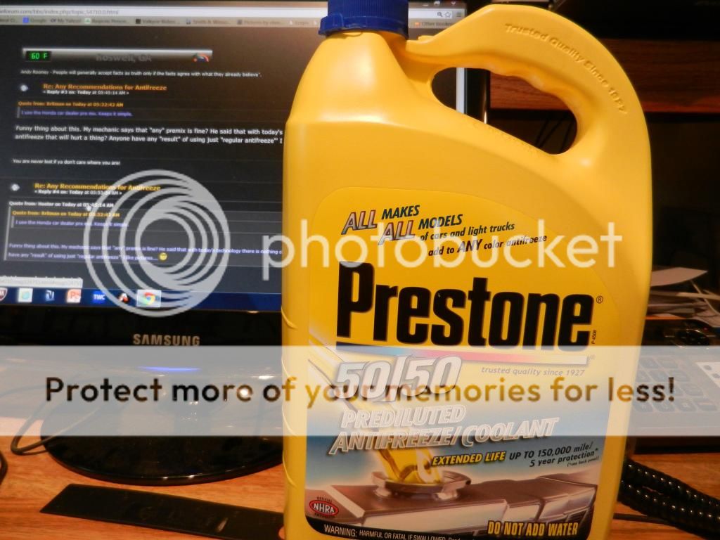

This is fine, or you can pay 4 times the amount for the kind that has a HONDA label on it.  I have been using this for 7 or 8 years now, no issues other than trying to decide which chrome pieces to buy with all the $$ Im saving
That's what I use.
