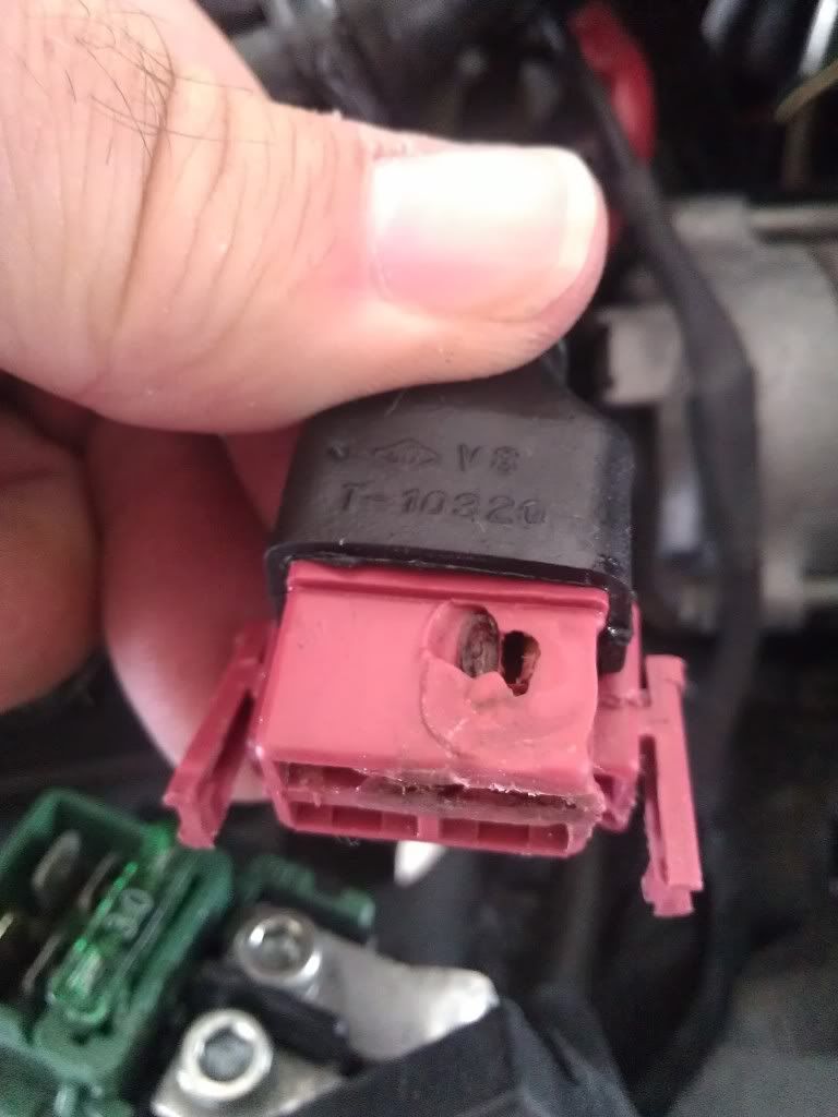

Check your starter relay under the right side cover.  Mine was melted when I checked it.

Probably time to pull the seat and side covers on a cold bike.  Start it up and start smelling around before the smell becomes overwhelming.  I'm sure the wife will be glad to help.   Grin
Starter relay and harness plugs seem like likely suspects.
