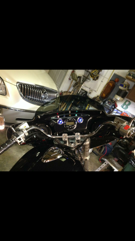

I never figured out how to post pictures but the plan is Glenn from Woody's fairings might post some to his website. We have found a way to put both of the gauges and a radio + all 4 speakers into the woodys fairing. No gauges on the bars!!! Still waiting on some parts to come in but once we get moving on it i will find a way to get some pictures posted.

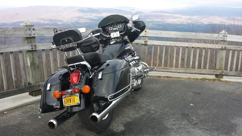

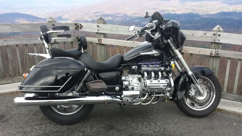

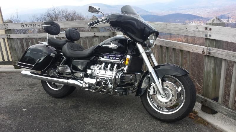

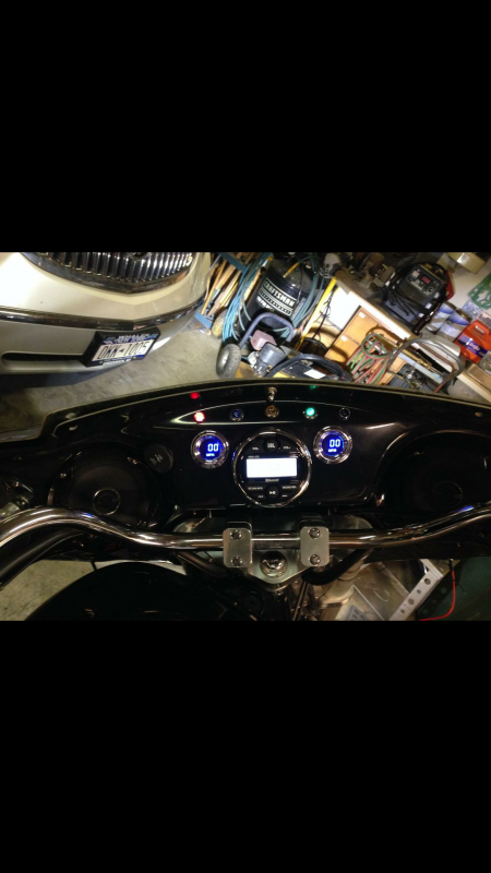

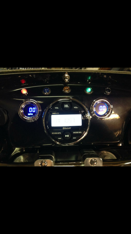

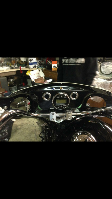

« Reply #11 on: November 19, 2014, 07:55:45 AM »
Matt,  Please make sure and post pictures. I would be real interested in seeing it.
Thanks
Finally got my major email issues resolved (I think  Roll Eyes).  Anyway, I promised I'd post Matt's pics whenever I got my email going again.  Finally got it back last night....and here's his pics of his Woodys fairing.  It is special and waaaaay cool.  Good job Matt.   cooldude
