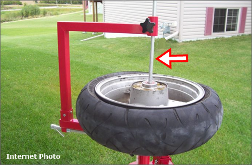

Understood. The shipping cost remains the same irregardless of how many in a single shipment becuz the individual stems weigh ounces, but still the principle. On a related note, I went and bought the HF tire changer/ MC attachment. What is the diameter of the vertical rod you need that replaces the HF pipe?
On mine, I removed the top "L" portion and replaced the HF center pin with a 3/4-inch rod. It doesn't move or bend ....  Cool .... and makes it much easier to walk around the tire changer while installing or removing tires.

On mine, I removed the top "L" portion and replaced the HF center pin with a 3/4-inch rod. It doesn't move or bend .... and makes it much easier to walk around the tire changer while installing or removing tires.
¾-inch, then. I'll try vith the L-bracket removed.
