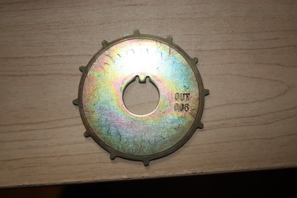

« Reply #14 on: August 18, 2009, 04:29:34 PM »
If I was getting that kind of mileage, I'd leave it alone & just ride 7734 out of it.
I get a solid 35 or 36 on the road & 30 to 34 in town.
I hear ya RJ , thinking the same , but my thinking was maybe I have a Trigger wheel already installed
wanted to know if it says 4-6 degree on an after market wheel.
This is my 6 degree trigger wheel.  I don't know what brand, but you can see the tips are round instead of square like the OEM wheel and it says 006 on the outside.  It worked well with the stock ICM but it didn't like the Dyna 3000 so I put the OEM wheel back in.
