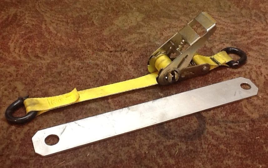

I also only use a centerstand for service.  I created a shortened ratchet strap which is placed on one set of shock mounts, to jack up the swing arm so the axle is above the exhaust.  It works well with little effort.
Hmmm. I never thought of that , thanks.
