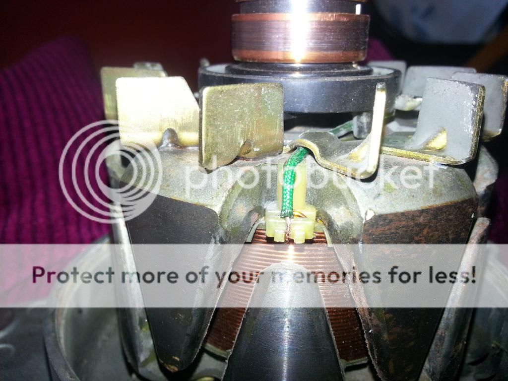

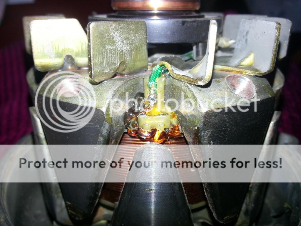

The failure in my alternator was an open circuit of the field windings in the rotor. There are two wires for the field windings. One of them broke right where the wires leave the windings and make their way to the slip rings. I repaired the break and I have continuity to the slip rings once again. Do I trust the repair to hold up like a new one? No, but I'll keep this one as a spare, at no cost, and take it along when I'm pulling my trailer. It'll be my security blanket.
This is good side.
This is the repaired one. The glop that you see is extra thick CA glue. The wires underneath are soldered together.
This is good side.
Good Repair,,,,    I've been in electronics most all my life and most transformer and coil failures that I have seen fail right at the junction point just as your rotor did, and not in the middle of the winding... I would also redo the "good" side as your repaired side looks to be a more robust connection than the original, then I don't think you would ever need to think twice about it. THe glue was good to keep the centrifugal force  from lifting the repair,, may want to add it to the other for balancing although I don't think it is enough to cause any problems.

« Reply #23 on: December 07, 2014, 09:44:46 AM »
In mechanical engineering terms that's where the stress risers are: the sharp bends, the changes in plane, and possibly some stretching. I'd use a higher temperature glue if I knew of one. And you're right about gluing the other side both for balance and reinforcement.
