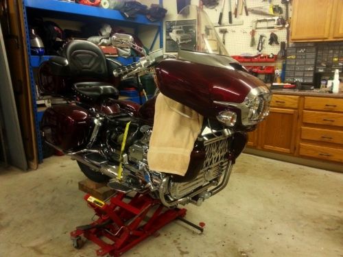

I just pulled apart my front end and ready to do some rebuilding. I'm going to have the forks rebuilt(already have the progressive springs), mirror polish the forks, and install new rotors and pads. It's my first time pulling the front end apart, is it normal that one fork appears to have some dampening left and the other is like a pogo stick?. I've never had any leaking.

« Reply #1 on: November 30, 2014, 02:40:27 PM »
Both should have dampening,,, better check to make sure the fluid didn't all leak out before you got the bike,,??  If so,, you will surely need bushings,, maybe a new tube,, at least.

« Reply #4 on: November 30, 2014, 04:31:19 PM »
My understanding of the system is one fork dampens on the down stroke and the other dampens on the up stroke.
I can't believe the fuild leaked w/o you knowing it.

« Reply #5 on: November 30, 2014, 05:10:17 PM »
The forks are very different from each other on the inside... you
probably don't have a problem...

« Reply #6 on: November 30, 2014, 05:44:17 PM »
Both forks are different, I pulled mine apart just for pm work and the right fork was bone dry no fluid at all, I bought my bike used

« Reply #7 on: November 30, 2014, 05:55:16 PM »
Both forks are different, but both forks contain (different amounts) of fluid...

« Reply #8 on: November 30, 2014, 06:40:04 PM »
While the hydraulic units are very different, they should both dampen,,, neither should be like a "pogo stick",, if one of yours is, you will find SOMETHING wrong when rebuilding.
I too think the paint job is nice,, looks great.
After thinking about it for a moment,,, it really depends on how much compression you are getting on the one that feels like a "pogo stick",,, if you are only getting an inch or two of compression is is hard to tell,, on the other hand, if you are getting 4 or five inches and it feels like a pogo stick,,, there is a problem.  If they are going to be rebuilt,, any problems will show up on disassembly and inspection.

« Reply #9 on: November 30, 2014, 07:12:58 PM »
You got the forks out so it's best to just do it all, the sliders, bushings seals etc.   You will probably notice the fluid in one fork is much different than the other. One might appear to be gear oil and the other red transmission fluid.  Just get some new synthetic fork oil to finish it off and call it good.
Check the steering stem bearings for indexing while you got most of the weight off it.  You should be able to feel it if there is any.
Have fun with your winter project....    And I agree, nice paint.
