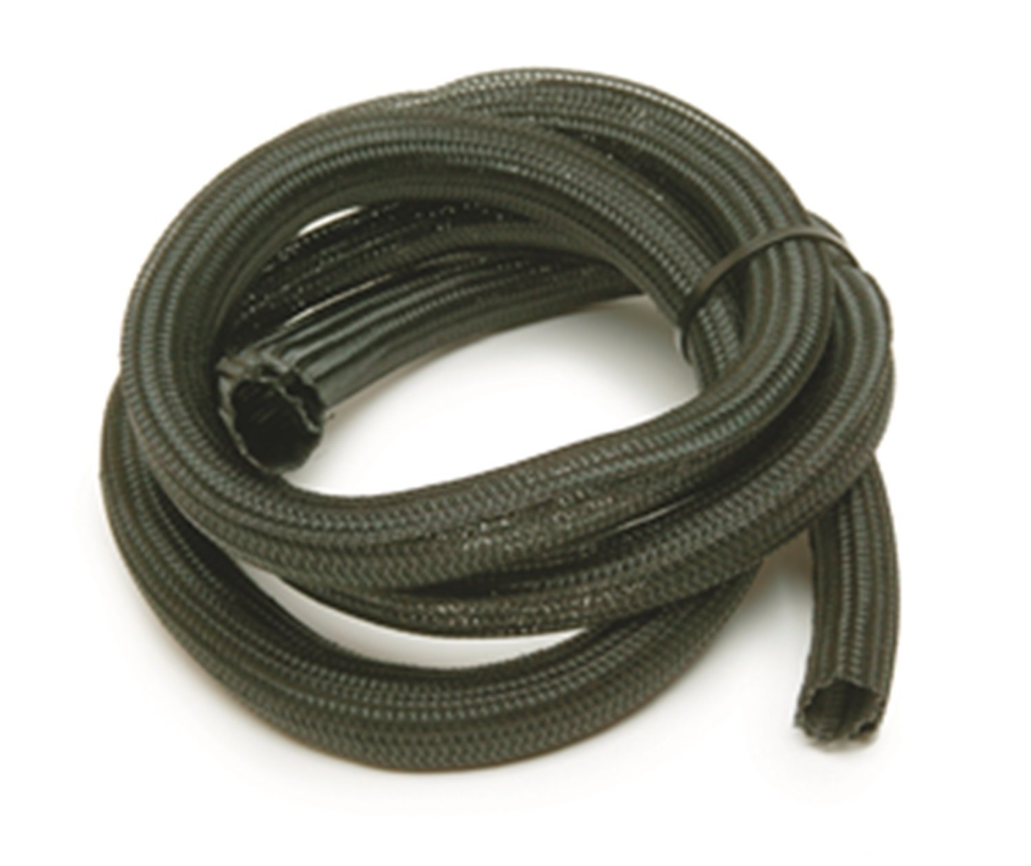

BonS
Posts: 2198
Blue Springs, MO
« Reply #18 on: December 08, 2014, 12:40:20 PM »
This is a split loom that opens up and fastens to itself. It doesn't have the vacuum cleaner look - as much. 6' will get you free shipping with Amazon Prime. It comes in different diameters
http://www.amazon.com/Painless-70903-Split-Braided-Sleeving/dp/B000N8IR2W/ref=pd_sim_auto_2?ie=UTF8&refRID=0B3YQ06AWC3ZHTYRTJ91
Posts: 16834
« Reply #19 on: December 08, 2014, 01:08:32 PM »
I googled around and found that four wheel drive places like that stuff... I just called the Clemson
4 Wheel Center (I can pass them on the way home) and they have it in stock  cooldude ...
I'll check it out...

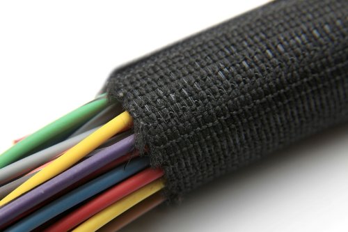

jimmytee
Posts: 2036
Elizabethtown,KY
« Reply #21 on: December 08, 2014, 03:25:47 PM »
Parts Express has some stuff here that would work well.
http://www.parts-express.com/cat/expandable-braided-sleeving/2193
Posts: 16834
« Reply #22 on: December 08, 2014, 03:49:17 PM »
I stopped by Clemson 4 Wheel Center ( http://www.clemson4wheel.com/ ) and
they had the very stuff that Bons posted about, I got 10 feet of it  cooldude ...
Seems like it will be real good to work with...
