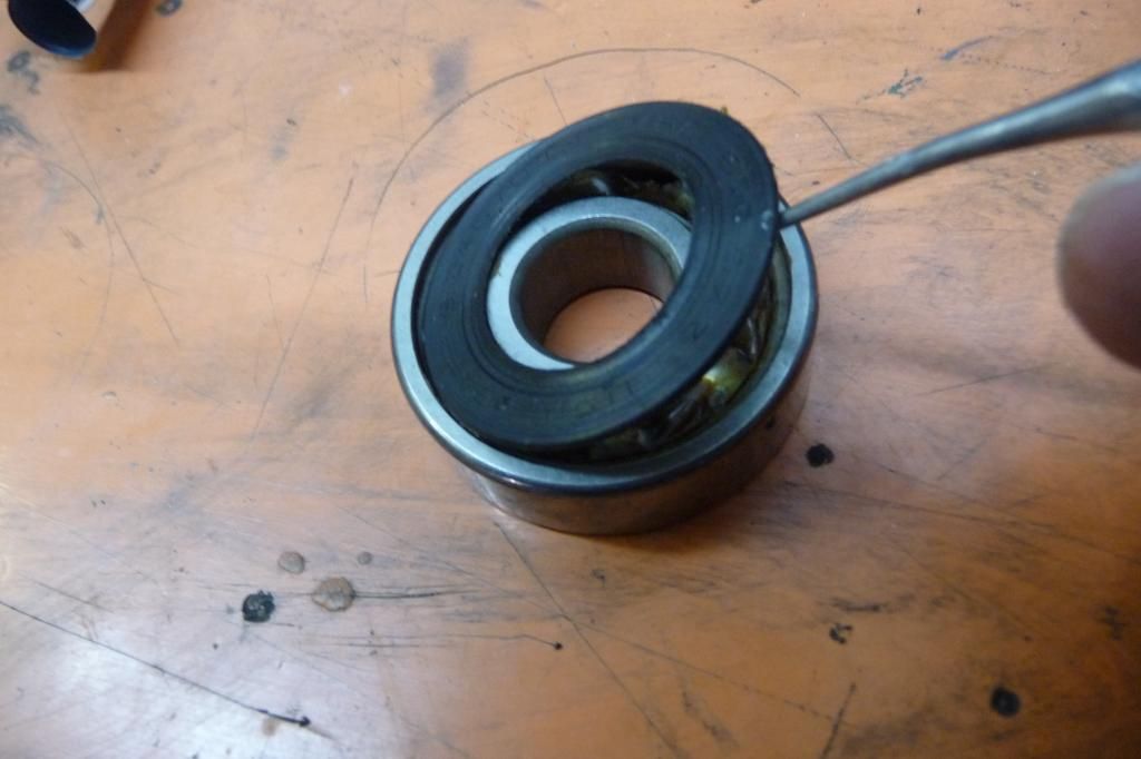

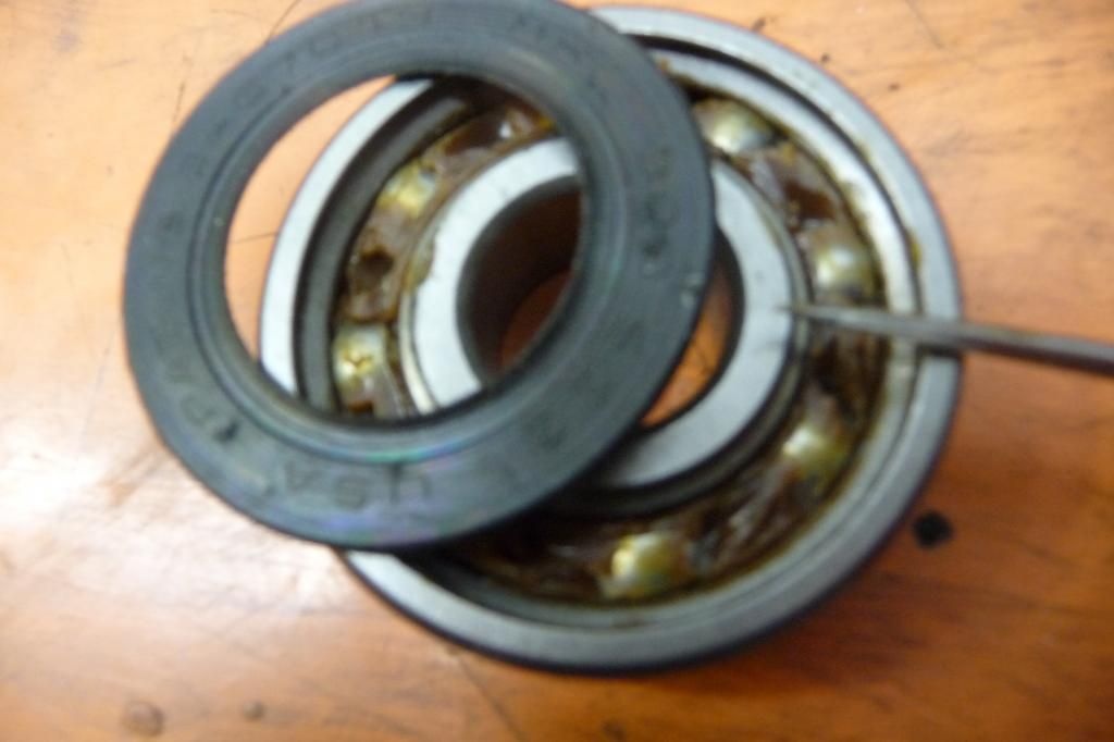

« Reply #11 on: December 19, 2014, 11:09:12 PM »
A sealed bearing simply means that a protective disk has been placed into a small radial groove machined into the outer race. The seal/disk usually is a metal disk with a rubber like material coating it. The outer edge of the rubber coating is a bit flexible and allows the seal to be pushed into the machined groove.  Use a sharp pick like a dental tool and you can get under the seal at the edge and pop it off..........pictured is a standard bearing pick out of my bits and pieces box. There is a metal seal with little notches cut into the outer edge of the seal that is more difficult to remove.
To put the seal back in, simply insert one edge into the groove and work it in pushing around the edges to the opposite side.

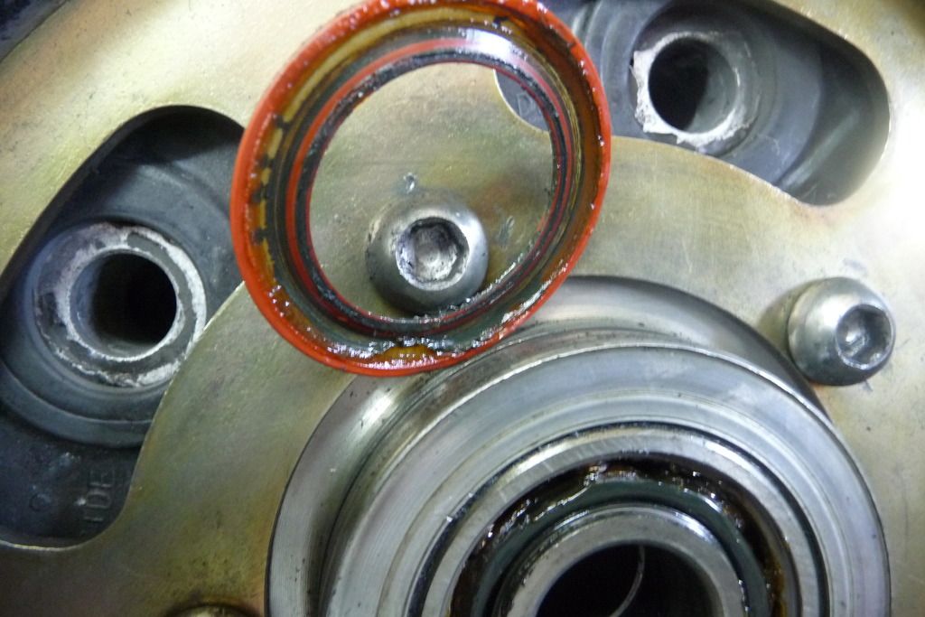

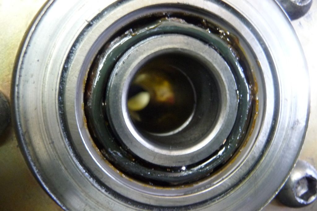

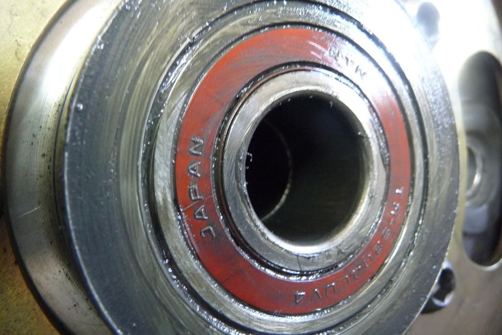

« Reply #23 on: April 21, 2015, 07:56:06 PM »
I had to do my 215K miles spline maintenance so while at it I decided to pop the seal off the double roll bearing to see the condition of the grease.  I had to replace the single roll at 205 K miles....that was my first rear bearing failure. Much to my surprise, it was still quite well greased and still felt smooth. Couldn't let a opportunity go to waste though, so I worked some more grease into the bearings as best as possible......maybe it will go 500K....... 2funny 2funny 2funny 2funny  popped the seal back in and good to go....... The greenish black ring is not gresae, it is the metal ball retainer/spacer ring.
I am a bit puzzles as to why there is a lip being worn in the shoulder where the yellow plastic ring goes between the drive flange and double row bearing......it has never been dry in there and the yellow plastic ring is in good shape.......mmmmmm
