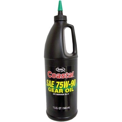

I think "Exceeds API service classifications GL-4 and GL-5" are the magic words, that's
what Pro Honda Shaft Drive Oil fine print says on the bottle.
This no-name looking stuff is what they had down at the otter parts store when I went looking,
it says the right thing on the label, and is in my final drive now...

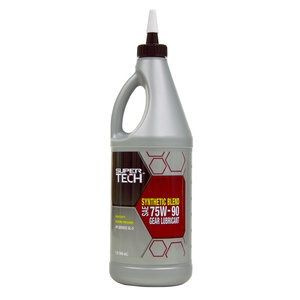

« Reply #2 on: December 20, 2014, 05:27:31 AM »
Should work just fine.  cooldude   I use this stuff from Wally World.
