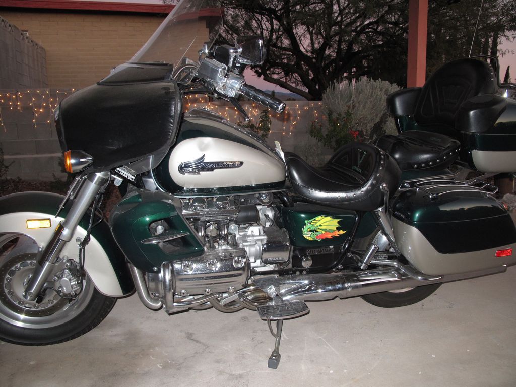

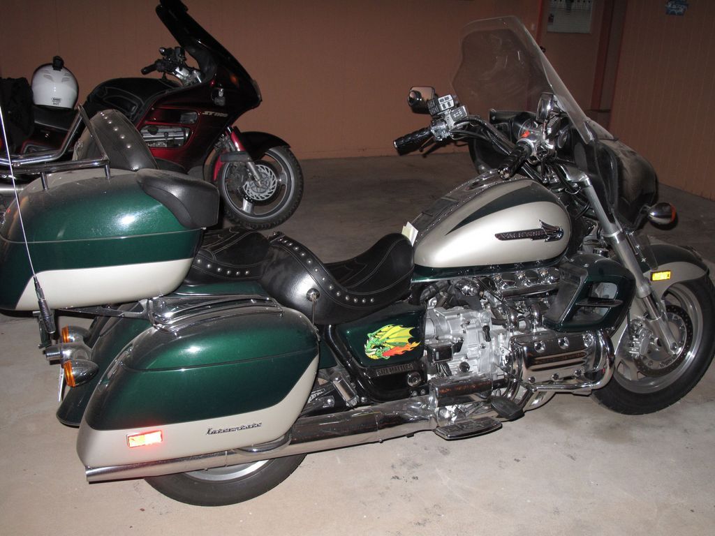

Long story short... Problem solved; I rode another...and took her home.   Merry Xmas to me! WinkSmiley Smiley  And the wife when she returns from her clan visit to Minny Soda - It was 12F there today...  and 55F here near Tucson.   Grin
Not my fav color, but I think it will grow on me...  The PO had it for about a year, and his PO put about $3k in maintenance and PM into it. Full carbs rebuild, balancing, tires, petcock, hoses, valve adjust, air filter, brake pads, throttle cables, coolant change, de-smog, fork seals/fluid, brake and clutch fluid changes, and various other stuff that I usually end up doing...  Smiley  About all I have to do is fork springs, maybe a fork valve kit, and maybe shocks.  Coming from a well setup ST1100 and a GL1200, this girl tends to wallow.  But overall it is in great shape and rides well... but the PO PO also cut the piggies - boy does it drone...  Gotta change that soon. Lips Sealed
It also still pukes exhaust.  Not as bad as the earlier one I tested, but the exhaust smell is very noticeable - but it is just exhaust, no gas smell.  Did some looking close b4 I bought her, and the exhaust is exiting the two small holes factory holes just aft of the entry into the collector. Did a search, and some others have reported the same - but no solutions.

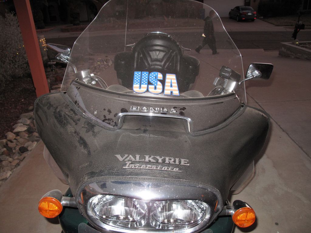

This beast (and the other I tested) also have mongo windshields - with the lowered seat I feel I'm looking thru the glass on a Prius.  My hypothesis is that the bigass windshield (and the air wings on the fairing and forks, and maybe the pods?) creates such a vacuum going down the road that it just sucks up and swirls the small exhaust flow (exiting the drainage holes) around the rider.  I have a shorty windshield I made for the Valk Hack, so I'm going to try that today on a Christmas ride as soon as it warms up.
This also has a car tire - my first experience with one on a solo bike - it is rather disconcerting at low speed turns - "Come on, TURN you pig..."  I'll try it a bit longer though b4 I decide what to do.  I put a car tire on the hack Valk, so I already have a pretty good Dunlop to change out to.
