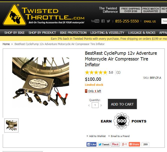

1.  A can of auto size (NOT beer can size) "spare tire in a can".  For a small leak, these have enough "goop" type stuff inside, and enough air behind it to get you off the road and into town.
2. A reliable 12V air compressor.  I've tried about 4 different flavors, and have settled on this:
Several folks sell them; also suggest the in-line pressure guage.  Unless you have already, need to install a 12V poweroutlet with good sized (12g) wires direct to the battery.

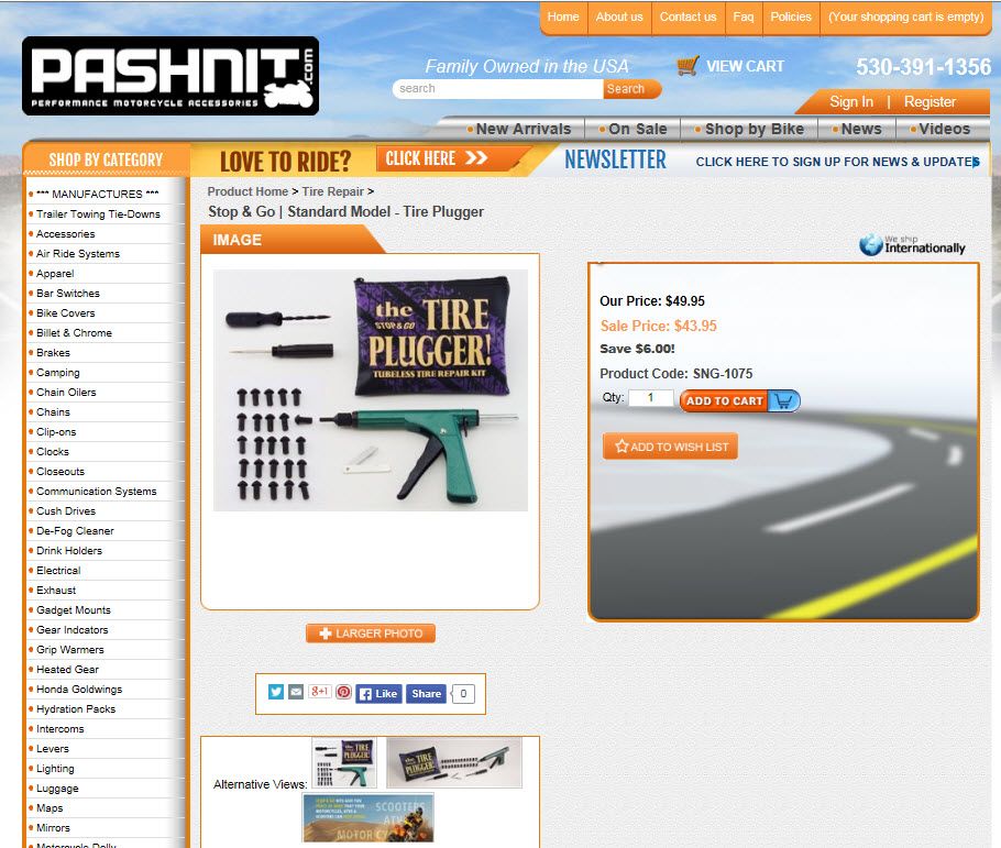

3. A well designed, hand gun type tire plugger.  This forces the plug into the hole.  Like this one:
I carry the air compressor, gauge, a 10' extension cord (have filled a few friends tires), the tire plugger gun/tools/plugs all in a small Pelican case EVERYWHERE I go.

you can get a smal tire compressor at any auto parts store for about $25 I have one that used to stay in the jeep when I had it. It is slow but will inflate a car tire to 40 psi.
