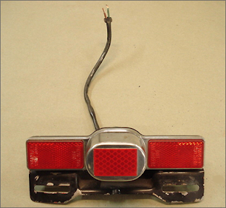

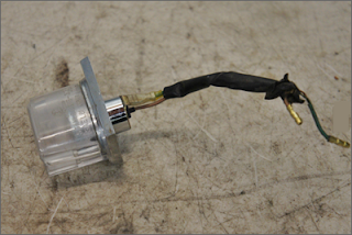

The bulb (#12) that illuminates the license plate goes into the bulb socket (#7).  Note the wires that come out of the back of that socket.
The wires that you want to get at are under the chrome plastic cover (#16).

I feel your pain, been there.  I replaced the license plate bulb with an LED bulb.  You have to remove the entire chrome housing from the fender, two nuts under the fender, to get access to the bulb.  It's easier if you remove the rear section of the fender and do it on a bench.  Careful, there are a lot of wires in a small space.

You mean like this?
Not sure if this is the right socket but there look to be other kinds by the same seller.
http://www.ebay.com/itm/like/130744129367?lpid=82&chn=ps
