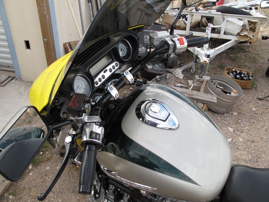

Jess - Sorry for the delay.  First day off in awhile, and I was packing to go on a 1200 mile round trip work road trip to TX.  Hope the f'ing cheese grater does not get me on I20...
Anyhow, below is a pic of the bars, on an IS with a modded fairing.  Love em.  Makes the bike more like a big Standard, as opposed to a big Cruiser.  Cables and hoses fit with no changes. The 6" Kury and ??? (somebody else makes a clone) risers had to have a bottom rong ground off - takes about 5 minutes if you have a belt sander upside down locked in a vice - need to be careful though...
As another poster mentioned, the bolt holes in the top triple tree also need drilling out - less than 0.125" IIRC.  Then I used a flat ss washer to fill in the depression in the triple tree.
Posts: 31196
« Reply #12 on: March 07, 2015, 09:13:21 PM »
Thanks for the pic.
I like the straight wrist bars, but I'm afraid I'd still have to reach too far forward, and off my driver's backrest.  They would be fine for awhile (and great for mountain twisties).  I have so many years and miles on the OE's I'm used to them.  But on longer rides my wrists can get to bothering me, so I ride one handed (both sides, using the throttle lock) for awhile.
It seems like no matter how you slice it, if you want more pullback (like OE), you end up with flexed wrists.
