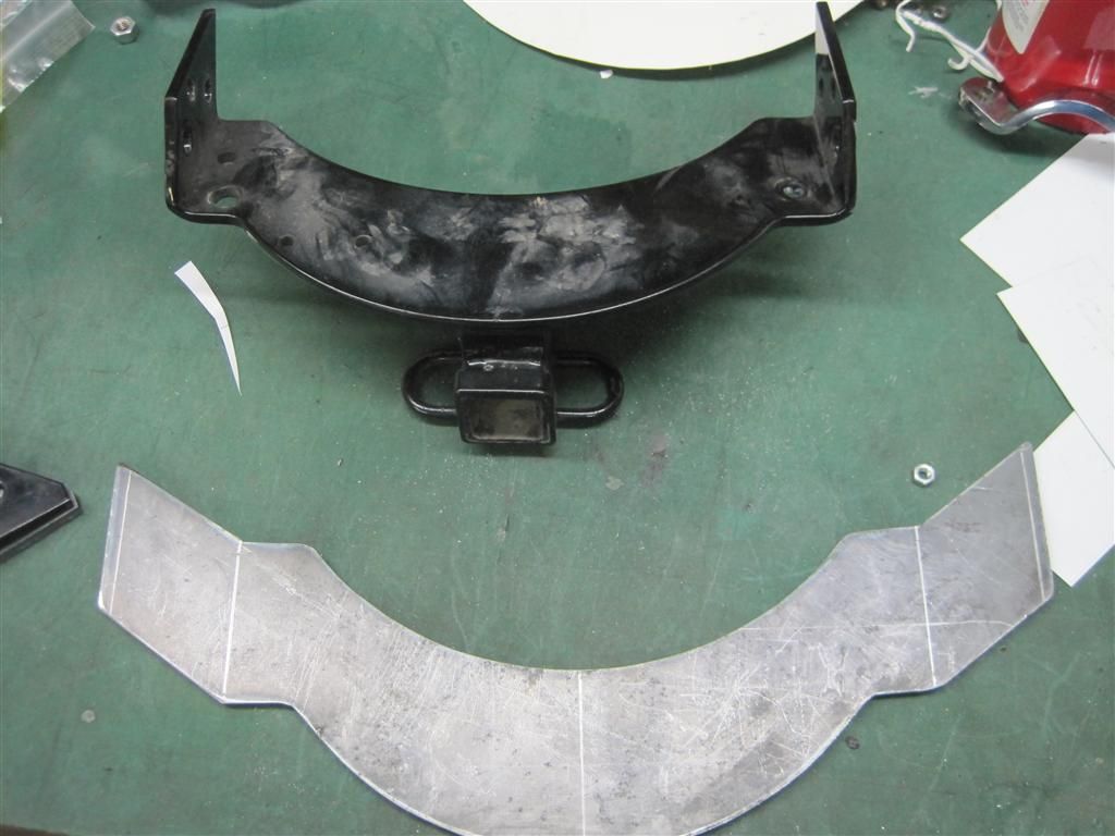

« Reply #3 on: March 03, 2015, 03:38:12 PM »
If you are talking about one of these I have some words of wisdom.

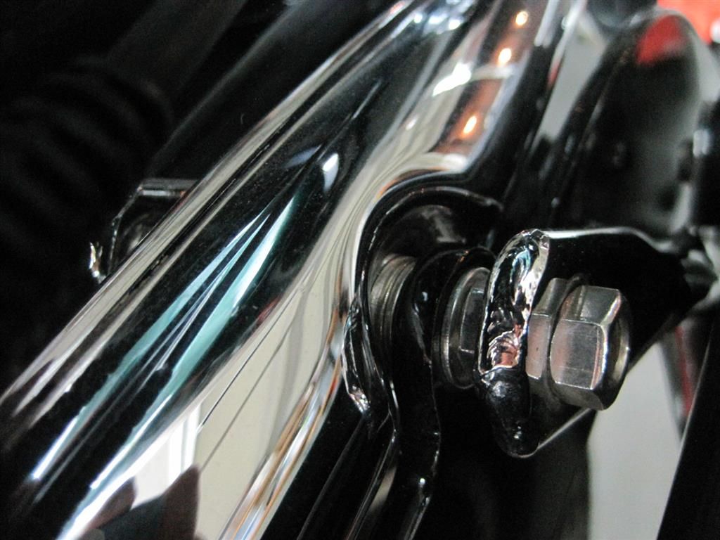

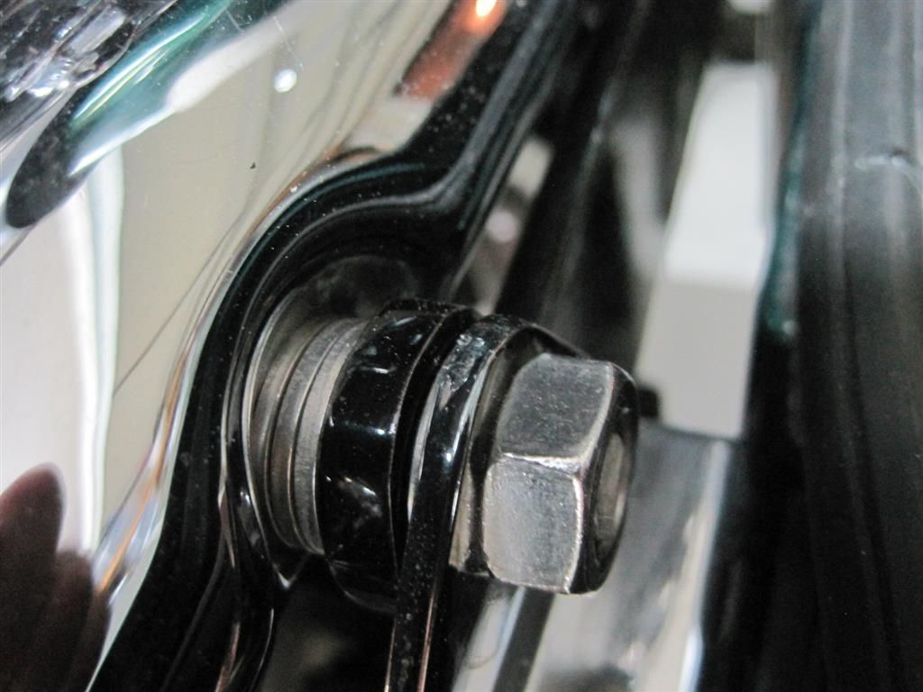

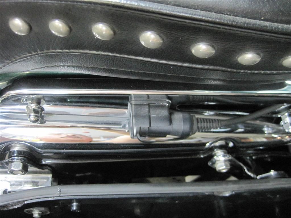

« Reply #5 on: March 03, 2015, 06:07:46 PM »
I make my own. And what I learned the hard way from BBP was that not all rear caliper clearances are the same. I bought one from them in 99 when the I/S first came out. I installed as per the "instructions" and I left for a trip. When I heard a noise upon rear suspension compression. The hitch was making contact with the rear caliper right at the bleeder nipple. it was shaving off metal.
BBP sent me a new bolt set and extra washers. Now when I make them, I shim that side till I'm sure it will clear. I also make studs instead of bolts it makes removing the bag hardware SO much easier in the future.
