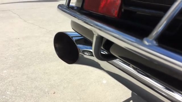

I am getting a little skip and sputter/pop on the right side.  Carbs are synced.  Can anybody give me an idea of what this might be?
Vacuum leak?
too rich?
too lean?
any ideas?
powered by Aeva
Update.  Pulled all intake and boots on right side last night and can't find any potential vacuum issues.  However, Today I pulled the exhaust tips off and the piggies have been cut off, but from the shop talk pages, that should not have created any difference.  Or did it?

[/URL
I am on the phone now and it does not show the vid.  Can't remember if I posted it or not
