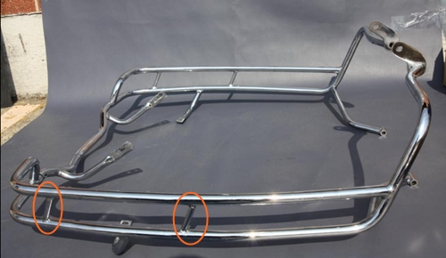

Well, the good news is that you don't have to pay large money for hard to find Honda OE bag rails (I paid $650, and was glad to find them); there are good quality knockoffs going for around $200 or less.
https://www.ebay.com/i/122572978789?chn=ps&dispItem=1
What you don't want is the MC Enterprises bag rails
Back when I sold my OEM's those knock-offs weren't available, to the best of my knowledge.  When I first saw the ones you linked (about a month ago) I thought they were OEM, but thought for that price they couldn't be... but was impressed with the quality.  Of course, one would have to do an actual side-by-side comparison, but from the photos they look pretty much identical.

I have not actually seen any up close, but the write ups have been very good.
Even the OEs, you have to bolt everything up extremely loosey goosey and then go around snugging stuff up once it's all together.
The shape of these knockoffs are identical to the Oem saddlebag rails, and also the size of the tubing is identical. That said, the welding isn't top notch ..... especially at the joint where the 2-inch vertical pieces meet the horizontal chrome members. They probably couldn't find a good enuff welder. Given, the factory probably used a welding robot to weld those circular joints perfectly, but the knockoff people could at least have filled the pin holes at these joints before chroming the rails.
Also, the 2-inch vertical pieces on the knockoffs have flat spots which show up bad when chromed. You'd think the rods used for the 2-inch vertical pieces are relatively cheap, so why they weren't more selective I dunno. True, from far away you're not gonna notice the discrepancies, especially if you've never owned the Oem versions, but they could have done a better job with a smidgen of effort.
