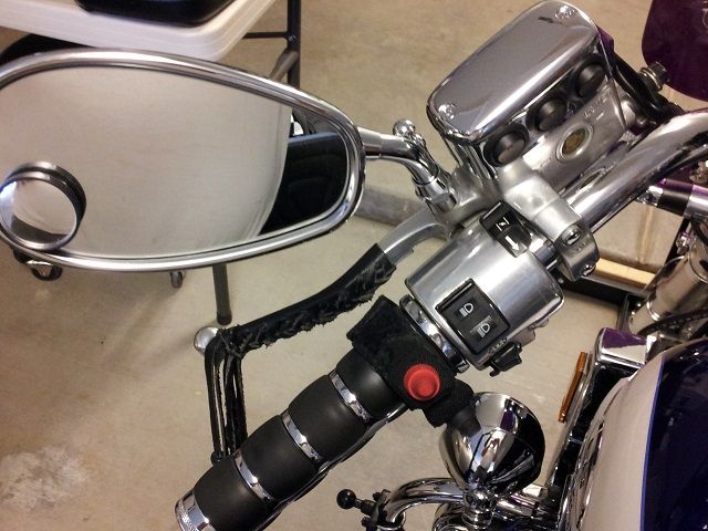

« Reply #7 on: March 22, 2015, 10:26:50 AM »
The CB is actuated using a push to talk  button on the left handlebar.
I use J & M comunications in my helmet. I operate the radio by batteries. A full charge can last 2-3 outings. The Cobra handheld has the option of hard wiring it. The Integrator I use requires a 12 volt source.
http://www.jmcorp.com/ProductDetail.asp?ProductID=HS-CD9279-UN-HO
In my case, the ptt is plugged into the radio and the Integrator. A call comes in and a response is given while the ptt is depressed.
Most of the folks I ride with use Ch 1. If there is to much "traffic" we move to another channel, only rarely. I purchased an extendable antenna which will give a about a 1/2 a mile to a mile on the flat, depends on the day. It's plenty when riding with a group.

« Reply #10 on: April 15, 2015, 06:28:49 AM »
Pancho I've used RAM mounting gear. It starts with a 1" ball that bolts through one of the handlebar clamp bolt passages. I use a 2" riser and then a iPad cradle that pinches the radio. I also use a black electrical tie to help secure the radio in the cradle. The speaker is not part of the radio system. It's to amplify feedback from the radar detector, just a convenient velcro mounting place. I like this mounting place on the bike because the radio is protected behind the winshield and easily operated here. Another thing you might want to consider is an extendable antenna for maximizing your range on the CB. Amazon has them, see below.
