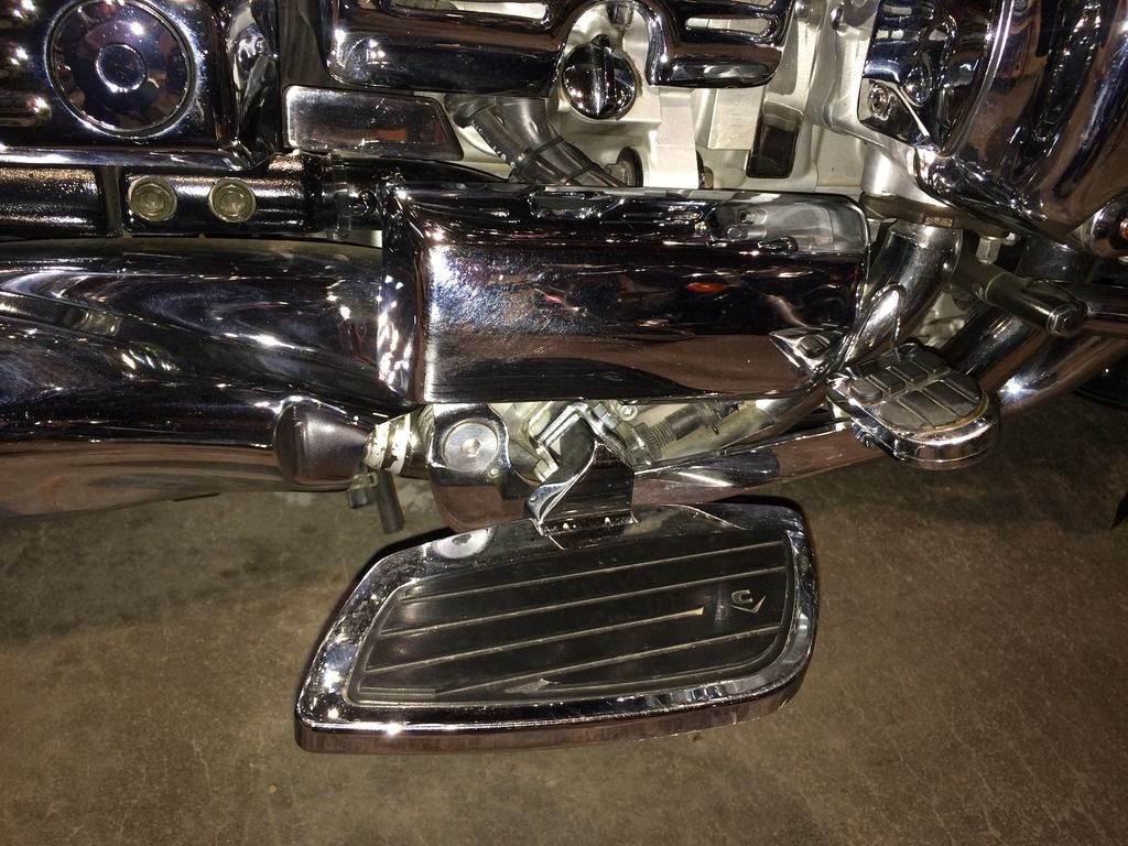

« on: March 24, 2015, 05:44:04 AM »
Hello everybody,
I will be removing my foot peg lowering brackets and heel-toe shifter this week. I'm going to keep my Cobra floorboards and use with the CBR-1100xx shifter.
My question is: How do I remove the lowering bracket on the right side? (I am assuming there is a lowering bracket there, because it is even with the left side).
* If everything works out with my new set-up. I will probably sell the lowering brackets & hell toe kick shifter.
Thanks!

« Reply #3 on: March 24, 2015, 07:54:34 PM »
It's pretty simple. After you remove the chrome cover you will see what's going on.
That reminds me. Make sure your new mounting bolts aren't too long. I bottomed one out and broke it off. Had a hell of a time.

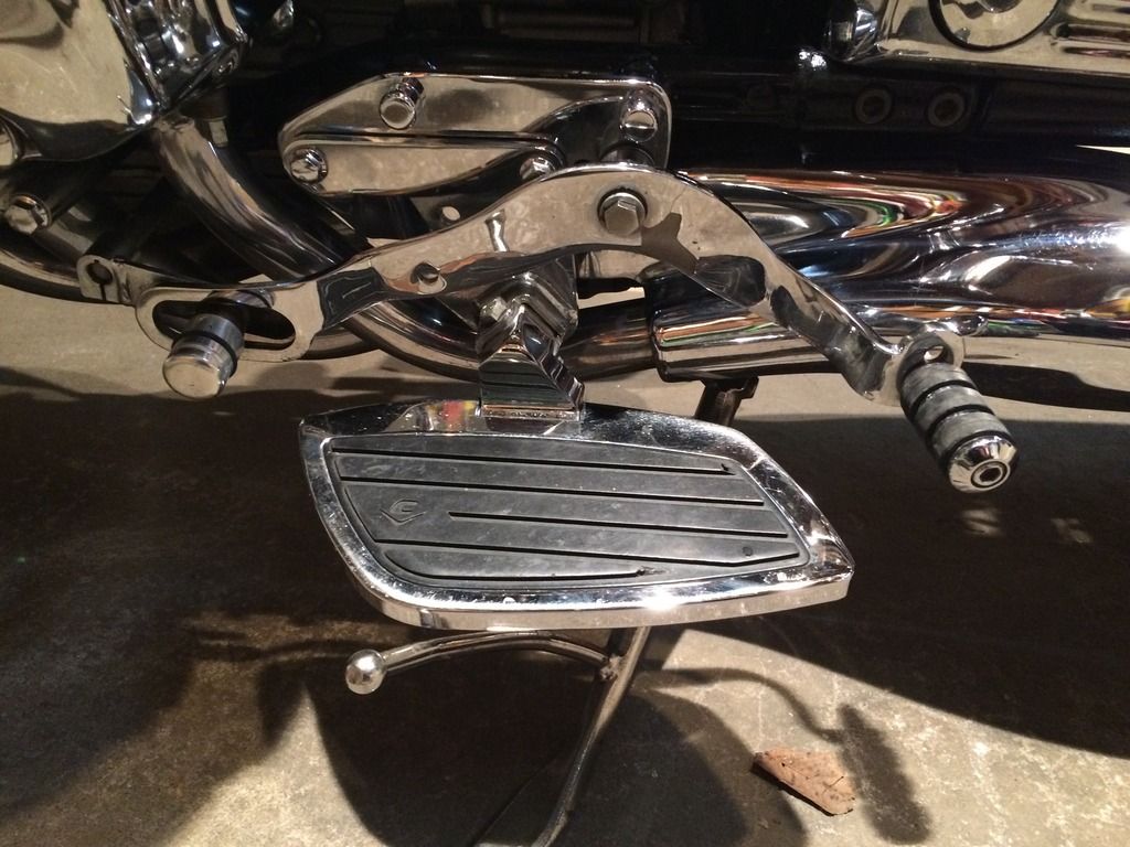

« Reply #6 on: March 25, 2015, 06:16:11 AM »
 cooldude If a lowering bracket is there on the right side, it will be apparent with that lower chrome cover removed. You can see the nose of the bracket on mine in the photo.

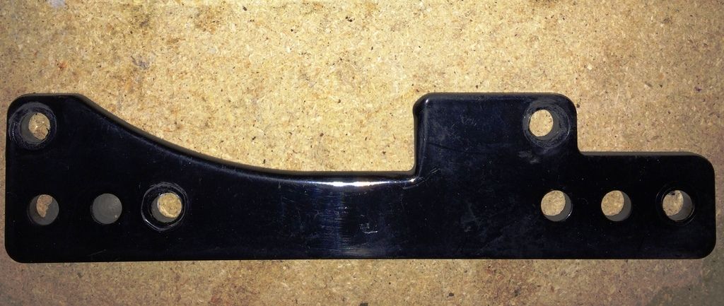

« Reply #7 on: March 26, 2015, 05:22:55 AM »
I just removed the right-side foot peg lowering bracket from my Valkyrie. It is completely hidden when mounted.
I couldn't find a photo of this anywhere on the web, so here it is....
« Reply #8 on: March 26, 2015, 05:25:34 AM »
Yep same one I have cooldude
