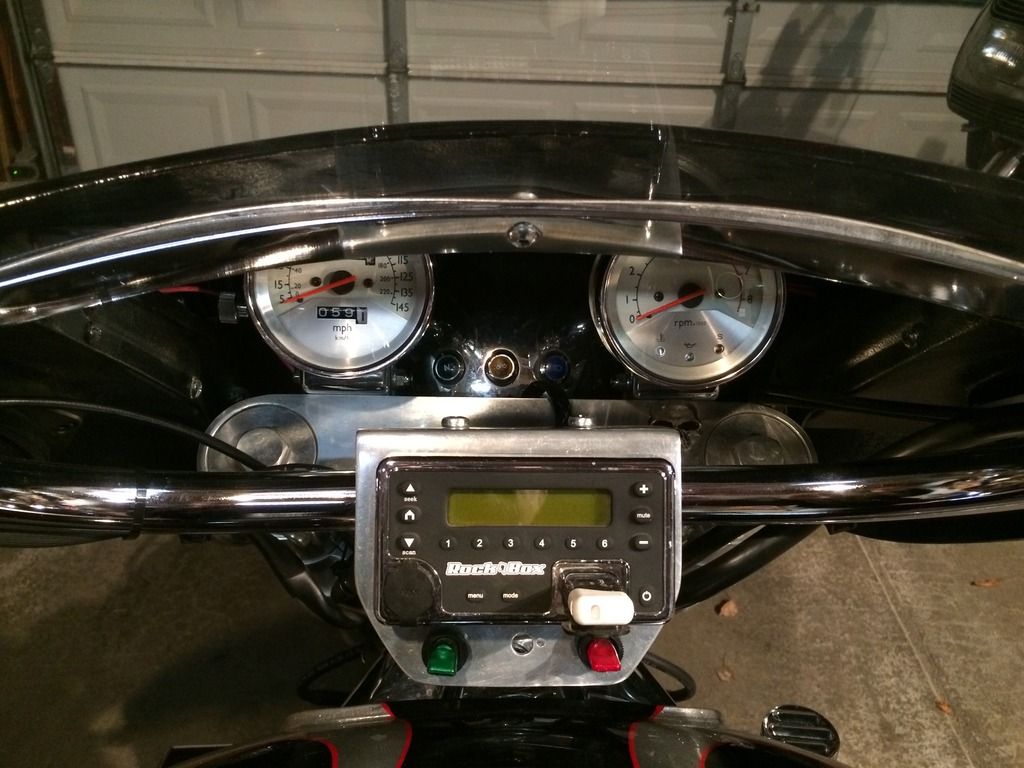

For those that have done this, What exactly is included in the kit? I didn't see a list on the site and it shows you need to select which fairing you are using so kits must vary.
« Reply #3 on: March 26, 2015, 07:29:51 AM »
Darryl at XF6 is the only one I'm aware of, and his price is what you stated...
http://www.xf6-custom.com/partpages/tach2.html
Black Dog
Not to be a smart ass, but everything you need...including a longer speedo cable.
Don't know about fairing differences (if any), but when I ordered mine, I did tell him that I had a Woodys fairing ordered.

« Reply #5 on: March 26, 2015, 09:10:48 AM »
I will tell you that the ones Darrell makes are top quality. He lives just about 60 miles from me and I have been to his shop. He does all the CNC himself. Nice guy.
