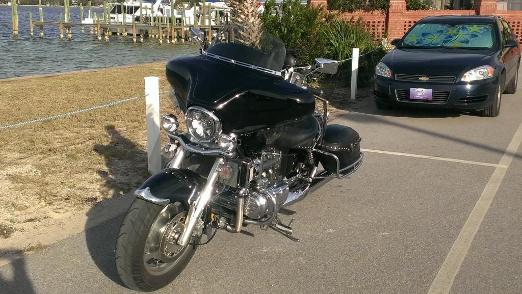

My bike used to have a Tourer shield on it before I gave the bike a make-over and put a Woodys fairing on it.
Putting a light bar on it was one of the first things I did to it.
I put on a light bar from Big Bike Parts on my bike.  I also added some driving lights and put them on the upper part of the engine guards.  They're also from Big Bike Parts.
The BBP light bar....
http://www.bigbikeparts.com/templates/product.aspx?ProductGuid=55-312&GroupGuid=16
I see that they make one with leds on it now (pretty spendy)....
http://www.bigbikeparts.com/templates/product.aspx?ProductGuid=55-312L&GroupGuid=16
These are the driving lights on my engine guards....
http://www.bigbikeparts.com/templates/product.aspx?ProductGuid=16-104A&GroupGuid=28
These next two pics are my bike before it's make-over.  Back then, it was a red and white standard with a Tourer windshield.
It's the same light bar....although I did change out the spots on it after the remodel.
As you can see from the pics, that light bar works just fine with it on a Tourer.  The windshield can be taken off and put back on with no problems at all.

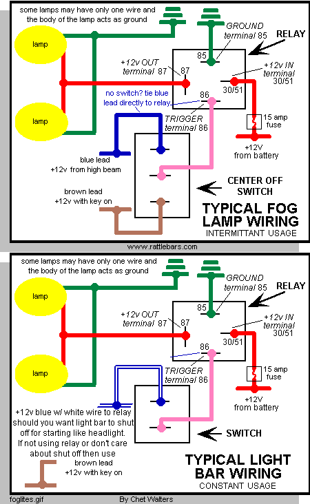

« Reply #15 on: March 29, 2015, 08:56:21 AM »
http://www.rattlebars.com/valkfaq/circuits.html

« Reply #16 on: March 29, 2015, 06:36:36 PM »
Thanks again salty1. Exactly what I had in mind.

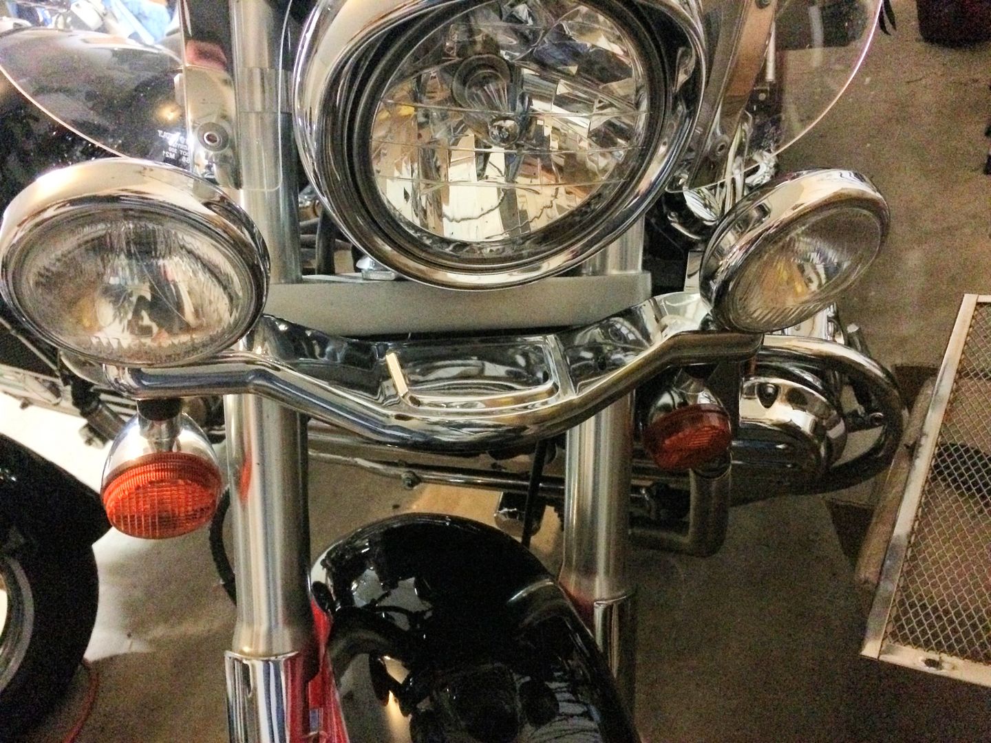

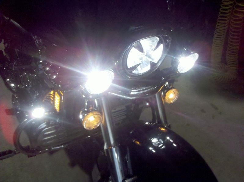

« Reply #21 on: April 17, 2015, 03:52:45 PM »
Thanks again for the experience and advice on a couple of nice upgrades to my '97.  Got the Wolo installed today.  Big improvement over the miserable Meep/Meep.  Now they can see and hear me.
Looks like it belongs there:
A little bit more chrome:
Both Lights and Horn share the same circuit (but separate relays):
« Last Edit: April 17, 2015, 03:54:33 PM by desertrefugee » Logged
