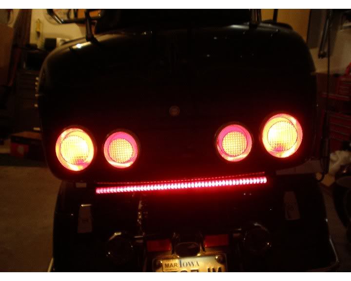

I've got this one on mine.
From Custom Dynamics 15" I got a piece of 1/2' alumnin angle iron to mount to the trunk supports and the light to the angle iron.
