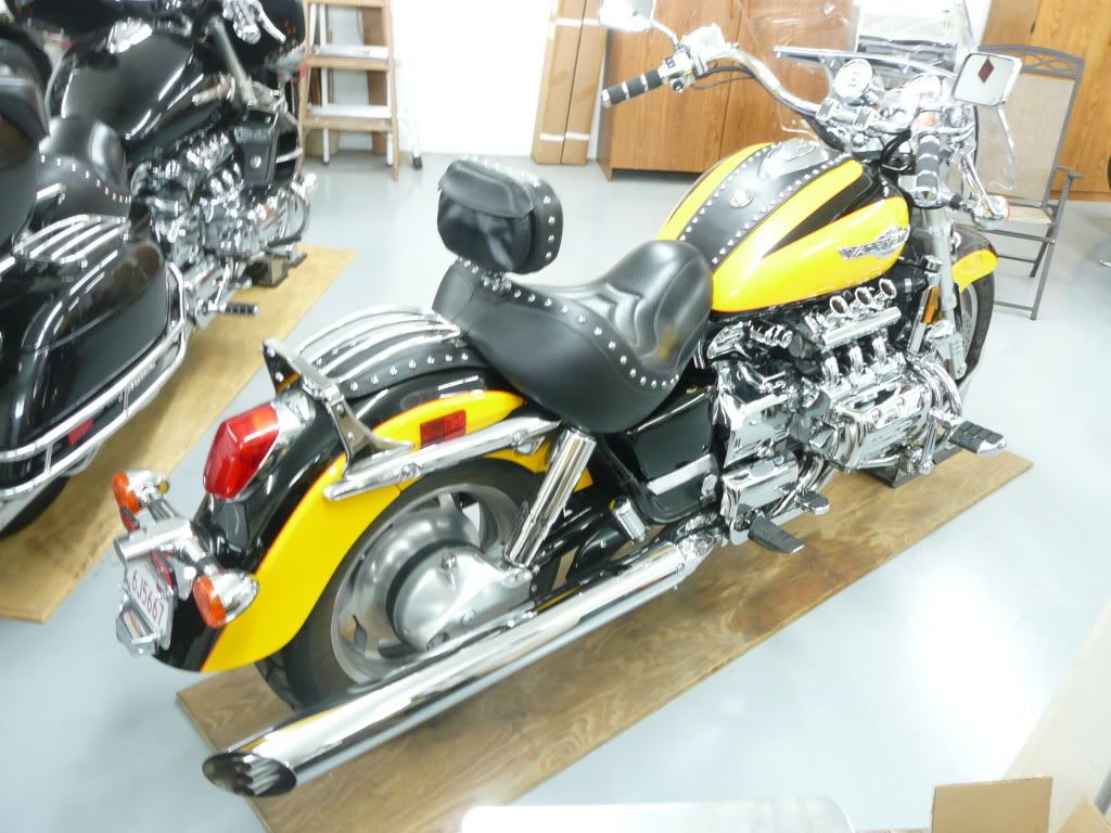

What I have is the 4" exhaust 18" extension from Air Flow, with the stock exhaust system in place with the piggies in tact.  What is quietest way I can make this system, plus eliminating the drone? I really like the look of the 4" and will keeping it in place.

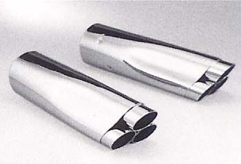

I'm referring to the one's that Honda produced as an accessory tip with the three barrels.
Pharmboy, your piggy extensions look great.  How did you make yours?
Here's a photo of the ones I have.  I'll try to get an actual photo of my setup with the extensions tonight.

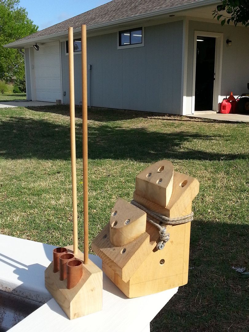

These extensions involved far more difficulty and time than I ever imagined when I started.  The extensions are from Aircraft Spruce & Specialty Co. (part # 03-06300) which has an ID that is 6/1000" more than the OD of the piggies.  A metal cut-off saw is almost a necessity.  (Measure twice & cut once.) Then it's polish & send out to be chromed.  The extensions were attached to the piggies by drilling & taping into the piggies once the extensions were in place. (I don't weld, but always wanted to.) The most difficult thing was making the Jigs to position the extensions and to drive on the 4" truck stacks.  There was quite a bit of head scratching & measuring since I wanted the extension to stick out 1/2" past the truck stacks and the extensions have to be attached to the piggies before driving the truck stacks onto the muffler.  I'll try to attach a picture of the two jigs that I came up with for these operations.  Making these took a full day's work and about every wood working tool that I own.  Without mounting truck stacks, making & installing extensions would be a breeze...Jim Smiley

I have a purely stock exhaust interstate with the only mod being the addition of 18" Air Flow flat cut tips vice the cheapo Honda tips (slash cut tips will be nosier no matter how you aim them).  It's pretty dang quiet (and easy to stall departing a stop, 'cause you can't even hear the motor at low revs).
The easiest way to make them quieter yet would be to stick on 20-21" flat cut tips that extended back ever farther.  You will drag them leaving aprons however.

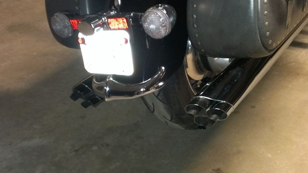

« Reply #11 on: April 16, 2015, 06:18:18 AM »
............and here's a pic of my piggy extensions.
