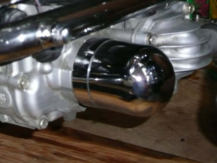

Purolator PL14612 filter and since it is an ugly mustard color, I cover it with a nice little Harley shock cover that is chrome plated. http://www.jpcycles.com/search/search?Ntt=7000095&N=28012814&Ntk=All  (They come in pairs, but you can always find someone that is glad to get the extra cover.) I have bought 3 pairs over the years...Jim Smiley
