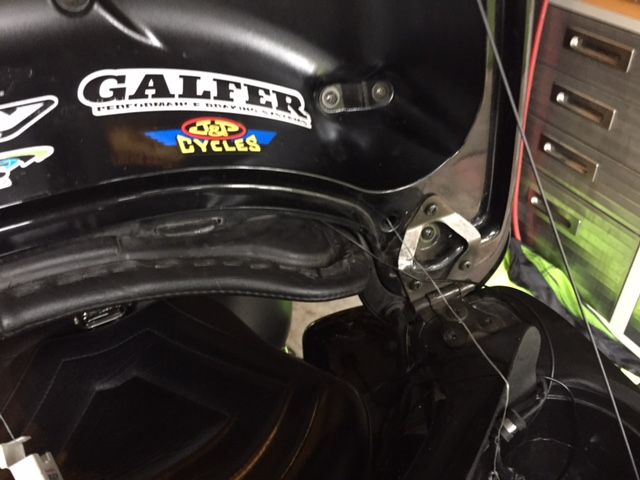

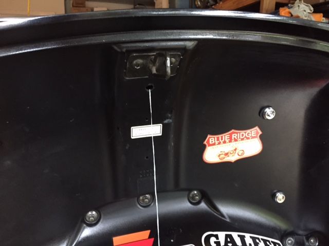

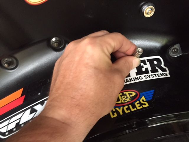

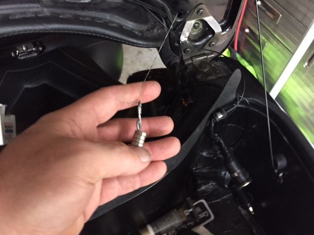

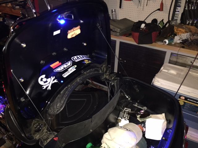

Installed my Trunk lid light permanent by pulling the wire thru the void in the lid.
Used a coiled piece of coat hangar, dental floss and a good stack of magnets. The coat hangar wire was bent to resemble an s or paper clip that was flat and would fit thru the 3/8 hole.
Drilled two holes using 3/8 drill. one just above the latch and one just left of the hinge in the casting dimple. Reamed the holes with 5 /16 bit to clean them out.
Started at the top hole and pulled the floss along the inside of the lid using a magnet to steer it from the inside.  Took several tries due to my XM antennae and Speaker magnets causing interference.
New LED light works well and really beats having wires hanging inside my trunk. Pulled and left a spare piece of floss in the lid in case I want to pull another wire. My hinge area is a dirty mess but it works.
