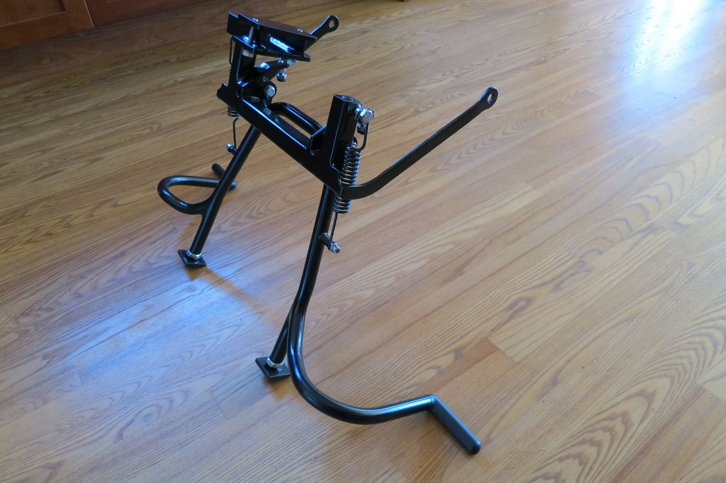

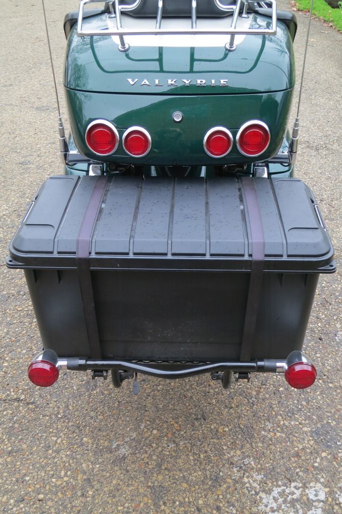

Built a symmetrical center stand and has been in use for over a year now. Center stand can be used to lift the motorcycle from either the left or right side. It is not possible for this center stand to touch down while in the retracted position.
Made a reproduction of the Hondaline fork deflectors with a slight variation to fit closer to the run-turn lights and mount to 4 degree triple tree.

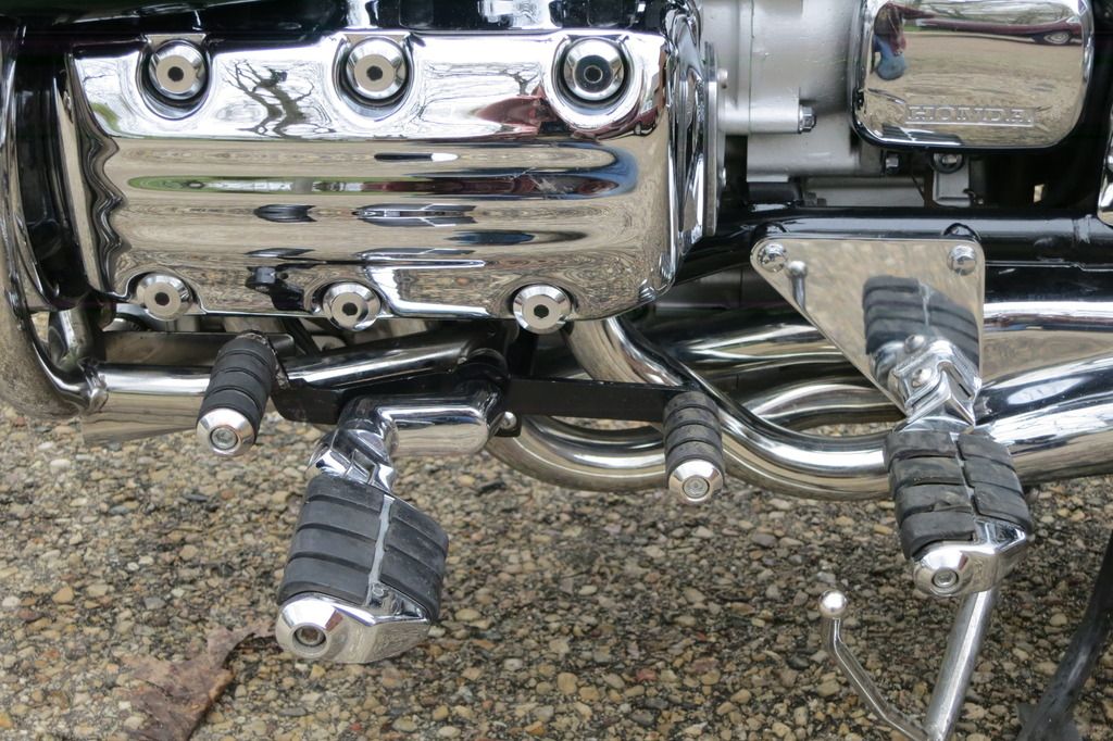

Designed and made forward controls; heal toe gear selector and brake pedal which can be used in normal foot peg position or on forward foot peg positions. Heal toe gear selector also dose away with the original long selector lever that has no support and improper pivot point.

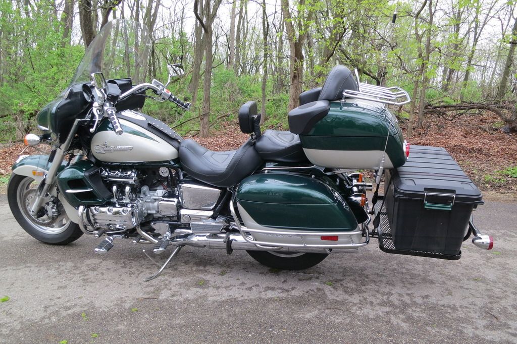

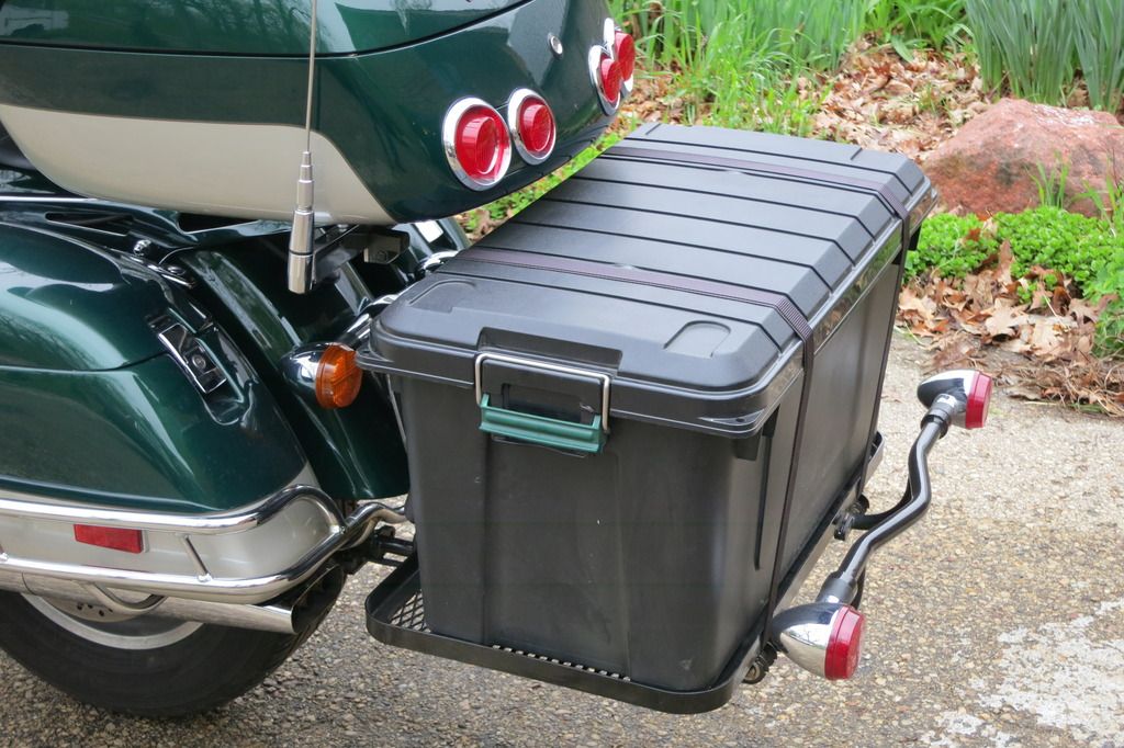

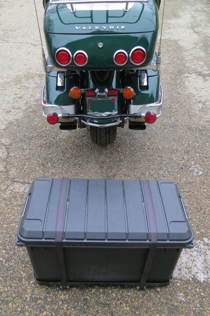

Added a light bar for more lighting directly to rear of Interstate which can be moved to the rear of carrier. Wiring plugs in at same time when light bar is slid into place on the rear of motorcycle or to carrier and can be changed in less than five minutes. Carrier mounts into my own designed hitch which pulls directly in line with lower frame rails and moves a portion of the weight directly over axle. Hitch can support in excess of 195 pounds, way more weight than the motorcycle can ever safely handle! I use a 40 pound max weight limit. I can have different trunk boxes, either loaded for travel or stored away. Next will be my own trunk box. Not recommended without the use of a proper rated tire!

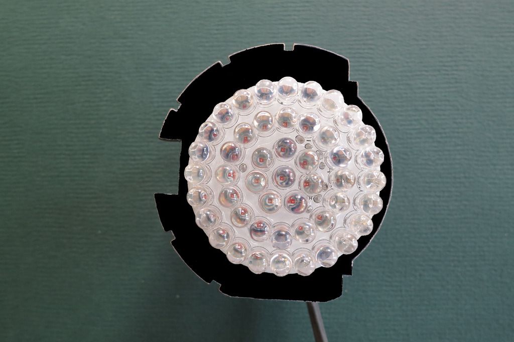

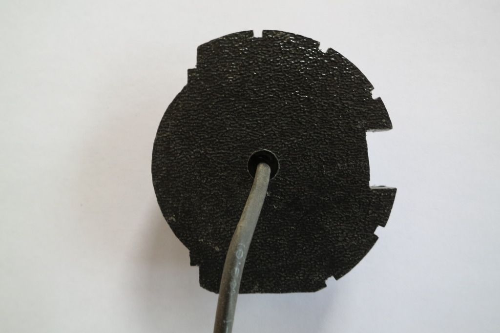

I changed all rear lighting to eight separate L.E.D. 48 array clusters and added a Stop Alert Flasher with g-force sensor.
I have traveled thousands of miles with the above add-ons; two up and camping.
« Last Edit: November 12, 2017, 11:38:56 AM by Avanti » Logged

Really impressive work, Avanti!   cooldude

Do you move your license plate with this trunk on?

I've seen this before, it is a work of art:
The controls look awesome too, I can't really see how the brake works, I think I
see a rod reaching back to the "real" brake...
I wish you lived near me so I could hire you to make a bracket for me, but I've got a few
leads for folks around here... when I get my bracket made, I hope it looks half as good
as your center stand!
No I do not move  my license plate. So far it has not been a problem. But I plan on putting it on my rear light bar, so it moves when I move the light bar to the back of the carrier.

 well, let's see, I installed Cyclops LED spotlights in the pods. I install Cyclops dual 7000 lumen headlights in the interstate headlight area. I replaced both throttle cables because the push cable had broken inside the sleeve. I changed out the throttle sleeve for a new one since my old throttle lock had worn out the original. But, with over 143000 miles on the bike, I figured that wasn't too bad.

14,000 lumen plus spots?!   Shocked  Sounds like I'm riding behind you to Billings!
All I did was this:

Trust me, I ask myself that all the time.   Cheesy   It's not easy.
And I don't have a forklift, pallet jack, or overhead hoist...   Roll Eyes

All I did was this:
I keep looking at the pic trying to figure out what you did.
