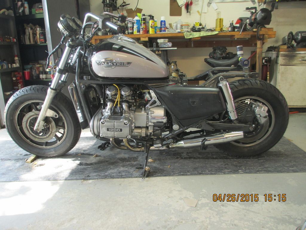

Need an opinion....or ten. Looking at the profile of the bike I'm thinking it might be kinda neat to just have a solo seat like the spring supported type you see on various Bobbers. With the Valk OEM shocks on there, the bike now sits nice and low compared to before. And the shocks give a nice cushion, so I'm thinking of mounting something similar to the seat shown in the Ebay link. Personally, I think it would look great but what say you. The original seat & pan fit on there just fine with the Valk tank in place, I'm just looking at something a little different, leaving some exposed area underneath but keep the side covers.

Jack, the seat in that ebay link is rather small....only 13.5" long. That would put the back end of it about where the shocks are with the nose about 2" in front of the forward crossmember. Others I've seen are 16" and more, taking it back about 3-4" past the shocks with the nose still about 2" in front of the crossmember near the tank. As for the rear fender, I'm going to mount it solid and needs to be about 7.5" wide to fit in between the rear frame members. If I don't use all of the rear end of the frame rails, I'll cut them off. Not to that point yet so will be a while.

Pappy, that's exactly what he did, I remember when he posted that. Here's some shots I took this evening, showing different approaches. What it amounts to is I need something smaller than OEM, and moves me back farther. Guess I need to install the engine guards so I can mount the forward pegs. Should give me a better idea of where the seat needs to be in conjunction with the Valk handlebars and the pegs.
My spare Valk seat, the later comfy version. It's waaay to big.
The original seat/seat pan, with the foam cut down. Still seems rather big to me.
Original foam w/o the pan and moved back farther.
Just tossed this in to make you all jealous.  Grin
An old rolled up blanket, so far the most comfy.  Wink  The seat position needs to be almost that far back.
