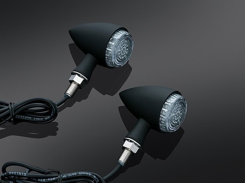

Just curious to see if anybody has experience with this product. Looks like just the trick to get rid the center brake light. I know some customs come like that, buddy has Titan and that is how his is set up. Thanks for any feedback! Clear lens, red run and brake and amber turn.

I did not use the KY-2509, but I did complete my SuperValk without adding a center tail light.
I installed dual intensity red LEDs in place of the rear turn signals. And, I wired them to my 4 wire trailer light controller.
The result is Red Run, Brighter Red Stop and Turn. While I was in there I also wired up my I/S Trunk lights up to the same trailer controller so when the Trunk is installed I get blinkers and stop lights from both sets of lights.
