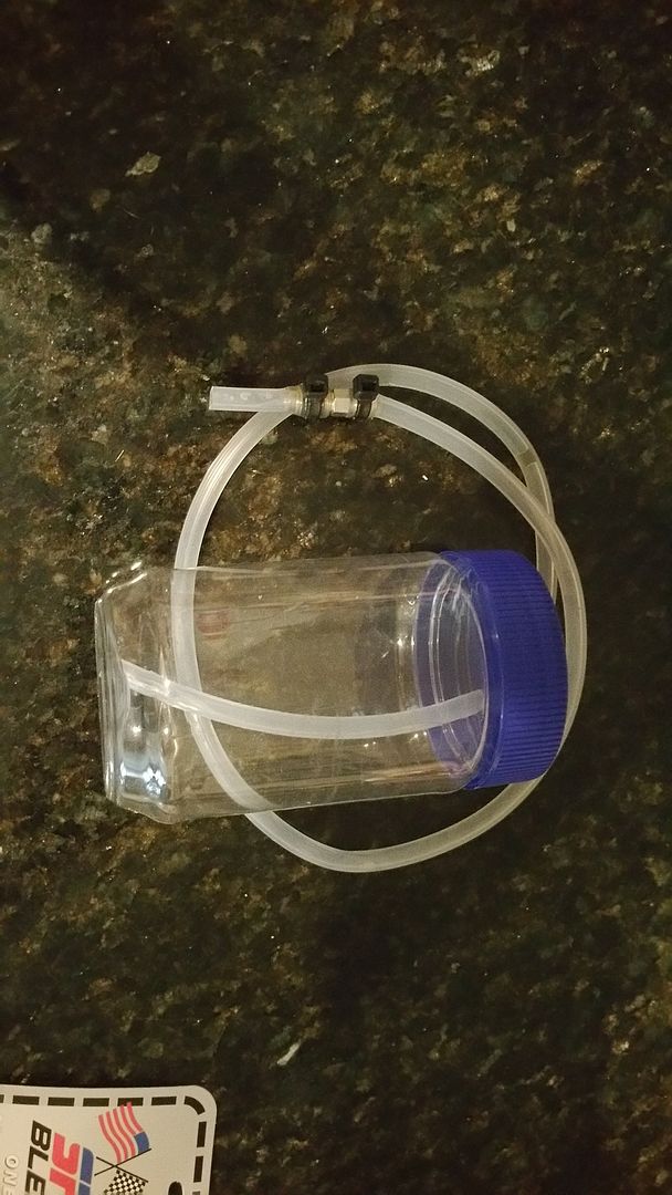

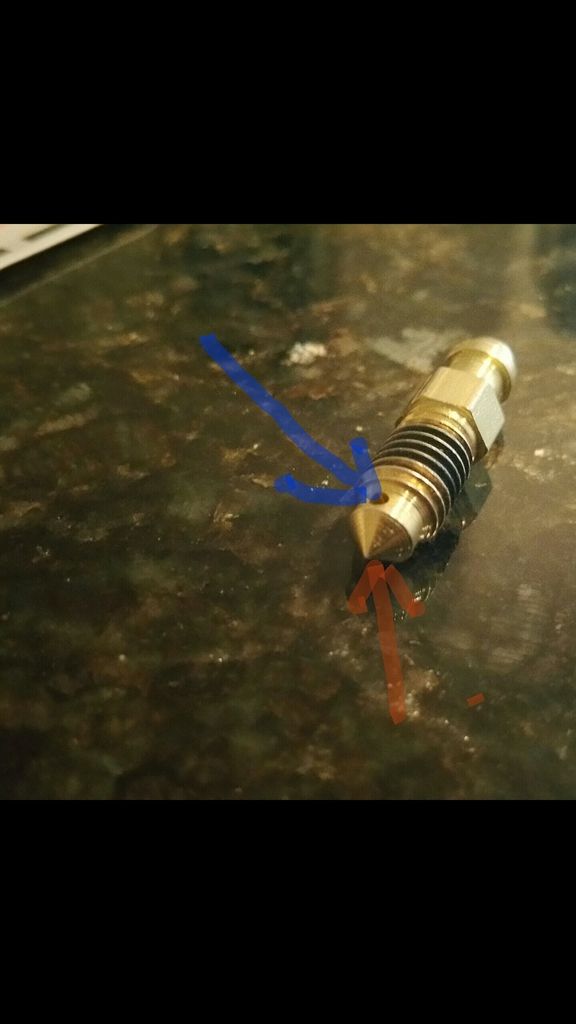

I flattened the point then drilled a hole in the formerly sharp end so it is not  blocked by the hose.

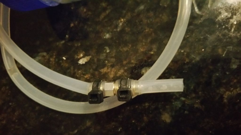

« Reply #41 on: May 15, 2015, 05:42:20 PM »
Then TY wrapped the silicone hose into the speed bleeder. The part of the bleeder that would be outside the caliper goes away fr the caliper.

« Reply #43 on: May 15, 2015, 06:02:09 PM »
The end hole is about the same size as the side hole. If I recall correctly it is about 1/16. Exact is not critical. Just not so bug that the little ball valve does not pop out.
I used a SB8125L (m8 ×1.25) speed bleeder. Once again, exact is not critical.

« Reply #44 on: May 16, 2015, 05:39:47 PM »
That's perfect.  Many thanks.
