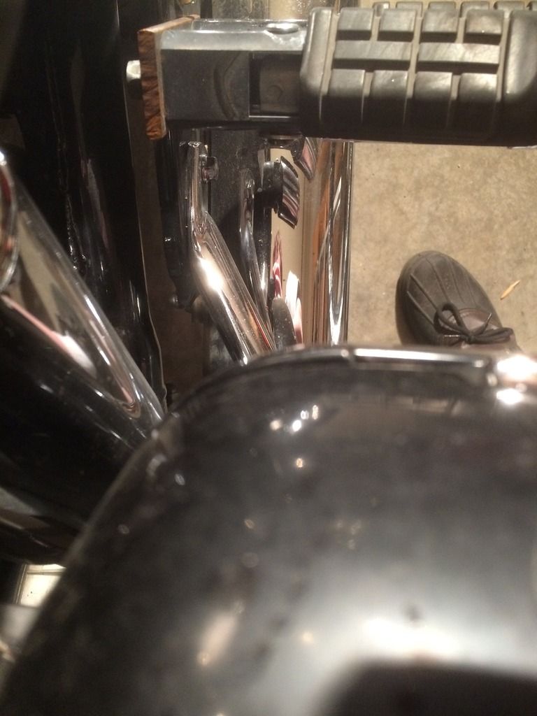

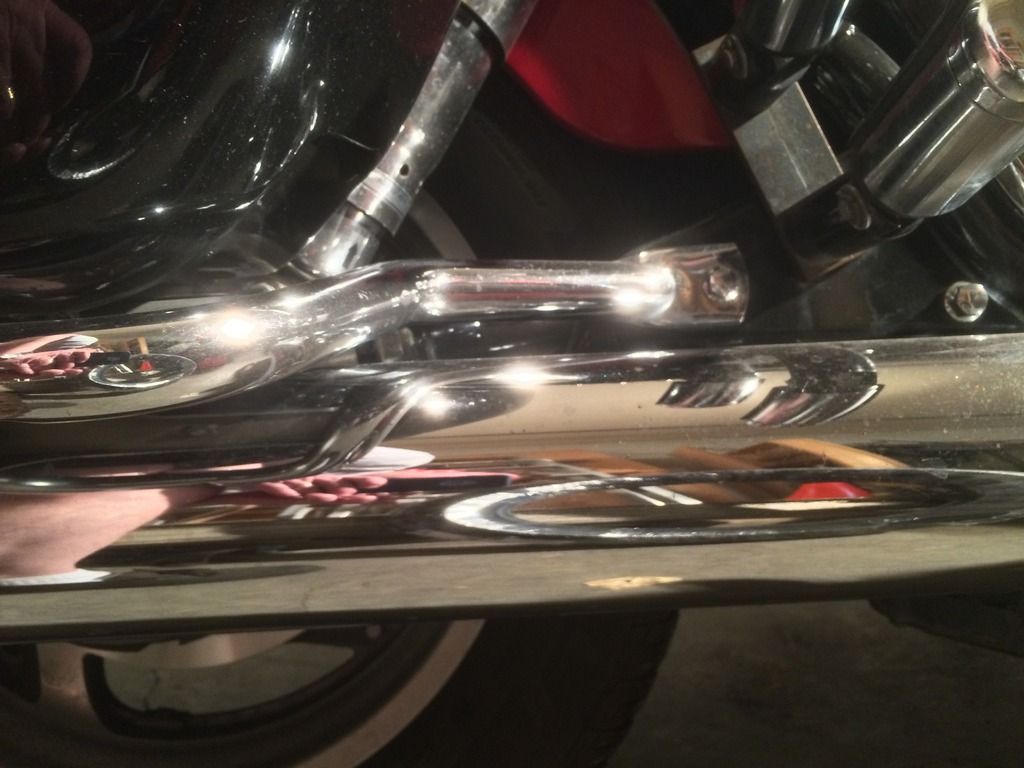

« Reply #2 on: May 12, 2015, 07:12:59 PM »
Took a couple of pics for you, one almost straight down, and one from the side. I hope they help.
[/URL]
Xtracho
Posts: 1303
The Bosses
Florida's Emerald Coast
« Reply #3 on: May 13, 2015, 05:18:16 AM »
Thanks Gryphon. That was it. Spacers ordered.
