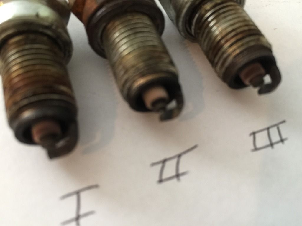

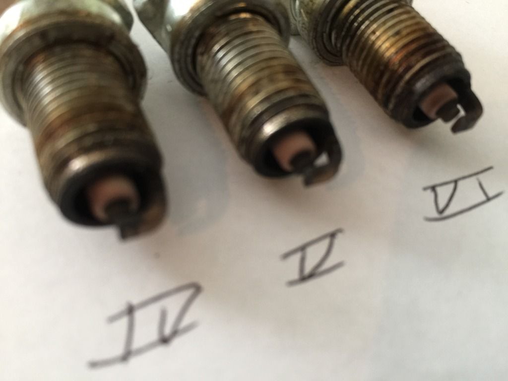

BonS, Could you tell me what devices are being used for transducers in your tool?? I want to take a look at the spec sheet just to get a better idea of the performance that can be expected,,, specifically, I wonder just how closely the curves of six of these devices can be expected to match each other.  Looking for the tolerances.
Quite an endeavor with all the required calibration, counting and averaging code, engineering, assembly, packaging and shipping.     Nice job bringing it all together,, do you have or work for an engineering outfit?

Now that I know all six carbs are precisely synced, I'm still getting a +\- 20 degree difference in header temperature at idle even after riding the Valk long enough to clear itself out and be thoroughly warmed up.
Plugs <1000 miles - NGK Iridium; 15,000 Total Mileage, Valve never reset; .38  low jets.
Is this due to improperly set pilot screws?
What else could cause the variance?
.38 Jets?

How are you getting your header temperature readings; IR or thermocouple? I like using a naked thermocouple that's been wetted with a drop of oil for the most accurate readings. IR devices are subject to variances due to surface emissivity that leads to readout errors or uncertainty. Is there any order such as front-to-back that the temperatures vary?

« Reply #21 on: May 19, 2015, 07:01:27 AM »
Bon,
I'm using IR. Never heard of thermocouple & oil.
I've got really high gas consumption even for .38's and can't figure what is causing it. Improperly set pilot screws are now my favorite suspect.
I see some black smoke out the exhausts, mainly from the left side when revving the engine up from idle.
Any suggestions? I've got new plugs, new air filter, and perfectly balanced carbs. I'm about out of things to blame it on.  I reset the pilot screws, I think properly, and thought I had solved the problem until putting the trike on the road.
This is the procedure I followed resetting the pilot screws:
http://www.valkyrieforum.com/bbs/index.php/topic,78142.msg766010.html#msg766010
I'm not looking forward to stopping at every third gas station between Little Rock and Spearfish.
Any help on this would be appreciated.
Dan

« Reply #22 on: May 19, 2015, 07:29:49 AM »
Two thoughts: Have you installed new float needles? The old ones get soft and can lead to a higher bowl fuel level that in turn leads to a richer mixture. The best source seems to be K&L from Amazon.
http://www.amazon.com/Supply-Float-Needle-6pk-18-8955/dp/B001KOD732/ref=au_as_r?_encoding=UTF8&Make=Honda|59&Model=GL1500CF%20Valkyrie%20Interstate|17894&Year=1999|1999&ie=UTF8&n=15684181&s=automotive&vehicleId=7&vehicleType=motorcycle
The second possibility, based upon the smoke could be your valve stem seals. You can do a compression check to eliminate rings but in my recent experience our valve seals are quite old and they have hardened. It certainly fixed my friends Valk since we replaced his, and balanced his carbs the smoking has stopped, period. I've followed him a lot: no smoke. Oil vapor in the fuel mixture can't be good for mileage either.
Ricky-D
Posts: 5031
South Carolina midlands
« Reply #23 on: May 19, 2015, 09:12:39 AM »
Those #38 idle jets are the main culprit for your poor gas mileage and if you did that you
may have changed the jet needle which, if you have done that, you should change them back to stock.
The Valkyrie engine normally runs rich to begin with and adding more gas does nothing but
carbon up the engine and reduce gas mileage.

Bon, Ricky D.,
I've never exceeded 30 mpg at legal highway speeds under ideal conditions. The mileage falls as speed increases, on curves & hills & headwinds all the way down to 18 - 19 when really flogged in twisties. Followers have commented on smoke from my tailpipes; when asked, they say black; gearhead followers say no blue or oil smell or belching off-throttle.
I haven't been into the carbs. The .38's were installed by the PO done by a Dallas area shop. I have the invoice.
All I have done with the carbs is to sync them and adjust the pilot screws using the DigiSync. The trike now runs great without any low-speed unevenness or doing the neat sounding " hit & miss " in first gear with a slack throttle.
Bon, as I told you when we talked, I intend to install .35's and new needle valves. However, being new to Valk carbs, I'm hesitant to do this so near to my impending trip to Spearfish.

Bon, Ricky D.,
I don't have any experience with mpg on a trike so maybe someone else will jump in and help out here.
I don't think it is intake valve seals. The Valk has only 16,000 miles; I've driven it 6,000 miles in the year I've had it; I changed the oil when I purchased it & in the 6K miles it has burned no oil; I just changed the plugs & the old ones showed no indication of oil fouling, ( pic. attached ); all plugs seem ok except 1 & 3 which seem to be the really rich ones ( incidentally, # 1 was bad out when I synced ); the smoke from the exhaust is definitely black, not blue and does not have oil smell, just gas; the tailpipe soot is not oiley; and finally, it doesn't belch blue or black smoke when throttle is snapped shut from high rpm.
I don't mind the way 1&3 look so I'd say that 2&4 look a little lean. No speckles or other bad stuff there, just a little lean.
I would appreciate you guys telling me which parts I should have on hand when in the way of gaskets, seals, etc. when I replace the .38's and the needle valves & also the preferable vendors from whom to purchase same.
I also intend to do a desmog in conjunction with the above and it seems that Red Eye Technical Services is most popular among the forum members.
Red Eye has all the miscellaneous parts you'll need for 0-rings and gaskets. Jets-R-Us has the jets and Amazon has the K&L needles as we've discussed.
Also, is there anything else to do while in this far such as the vacuum hose to #6 and the intake O Rings?
You can generally use 5/32" hose to replace the oem petcock hose and Red Eye has good intake o-rings. If you don't see any buildup at the base of the intakes then your o-rings may be just fine. If you're already placing an order with Red Eye you might as well replace them.
I probably will replace the coolant hoses also while in there.
Is there anything else I should consider doing?
Dan
pic attached
I either have the only 12 cylinder Valk in existence or I'm not very good at posting pictures. I'm stopping while I'm ahead.
