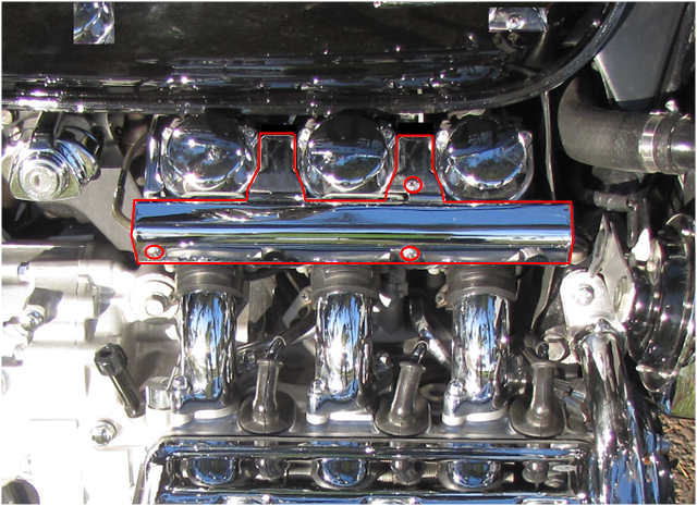

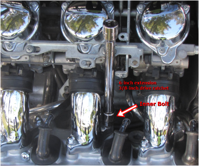

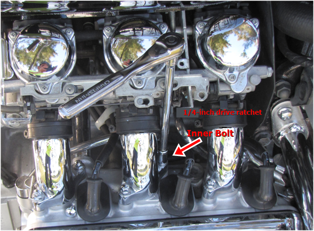

Something else that hasn't been suggested, but can be a major contributor, and will only take 2 minutes to sort... the clamps at the top of the intake manifolds.  The come loose.  Make sure they're tight.
Just did this tonight on my new to me valk.  It seem to be running fine once it warmed up but ran like crap until it warmed up good and I could swear I smelled gas every time  I came to a stop but could find no leaks.  I found all six of them loose, not rattle loose but I did a couple of turns on each one.  Didn't want to tork on them too much but I snugged them good and what do know, no more gas smell and it warms up much better.  I guess you can teach an old dog new tricks.
RonW
Posts: 1867
Newport Beach
« Reply #18 on: June 12, 2015, 08:38:04 PM »
Just a nuance but it's been bothering me night and day 7 days a week and probably for the next 20 years, lol. In an earlier thread about replacing the o-rings for the intake runners, there was something about not having to remove the choke covers (carb covers ? ) .... to access the bottom bolts. There are two bolts at the bottom of each intake runner. The inner most bolt is tucked in there. Is the *choke cover* what's outlined in red in the pic below?
If that's indeed the *choke cover*, I don't understand how you won't be fumbling around torquing down the inner bolt without removing the choke cover. Besides it only takes unscrewing 3 screws to remove the choke cover. Just a few seconds so forth. 2nd pic below shows a ¼-inch drive easily reaching the inner bolt with choke cover removed and not an obstruction. The last pic shows a ⅜-inch drive extension if you have a torque wrench that reads down to 7 ft-lbs.
« Last Edit: June 12, 2015, 08:39:37 PM by RONW » Logged
