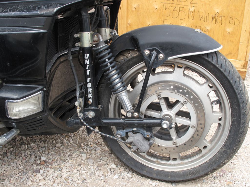

I believe Unit in the UK still makes them custom,  About $2500 plus shipping when I checked last for my GL1200 maybe 3-4 years ago.
Wasp motorcycles in the UK also makes them custom.  Had them make a set for my XR1200 a couple years ago.  A little more than the Unit guys, but they look a lot less...kludgy.  Recommended, but it takes a few months.
I think that DMC in WA also makes them custom.
Would love to hear if you follow through with this.  Almost have our Valk/Motorvation Hack on the road, and am thinking about the leading links.  I went a temp solution with 6 degree trees and 1" over fork extenders.  It should work out, but I tend to push rigs hard, and leading links are the ultimate.  It's spooky seeing lateral fork deflection on 80 mph sweepers...  Shocked

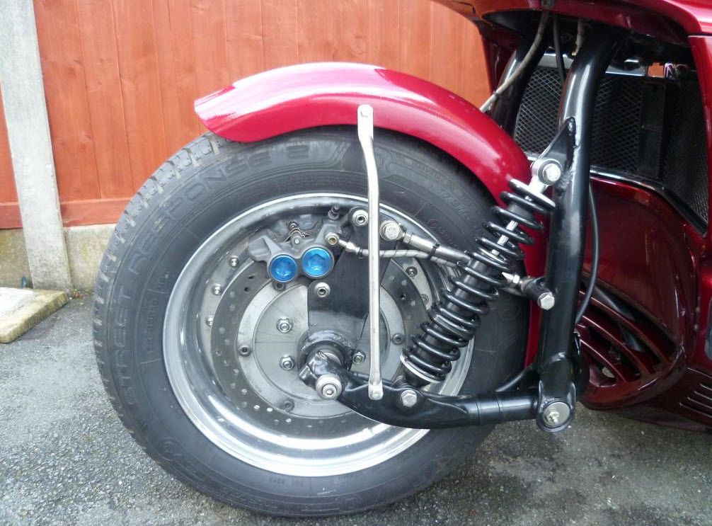

But I do have some pics of the LLs that Wasp did for me on the XR.  Wasp did not invent these... but they have been doing them for decades.  Here's their site:
http://www.waspmotorcycles.com/index.html
True Leading Link porn... Grin
These had 5" of travel.  I'm thinking the Valk would be about the same.  I have emailed them to see if they have done a set for a Valk.  Will let you know what I find out.

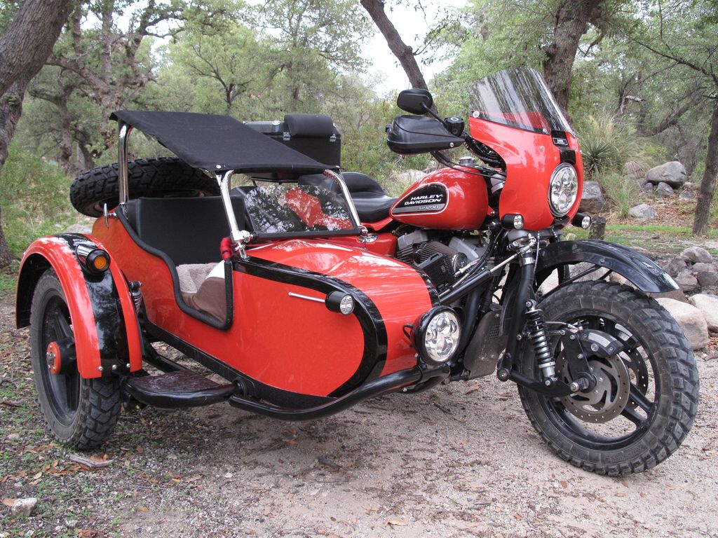

Anyhow, here's a pic of what it looks like on the XR.  May need to do something on the trees though.  IIRC, max tube size Wasp can do is 1.6".  We ended up with about 1/8" inserts to make them work with the XR USD fork diameter.

What a great looking rig.  I'll bet you did push that one pretty hard.  Do you still have it?  Looks like a sport rig, not a cruiser.  Gary

Thanks.  Well, we ride em.  On the XR, that means 75-80 mph going down the freeway, and then 5-15mph on fireroads a few hundred miles from home.  We did the first 2 legs of the CDR (Continental Divide Ride) two years ago; the Mexican Border to Pie Town.  Hopefully the next 2 this fall.  I have learned to ensure any hill we have to go down that I can make back up... Embarrassed  I also carry a spare clutch, tools, and oil these days... cooldude

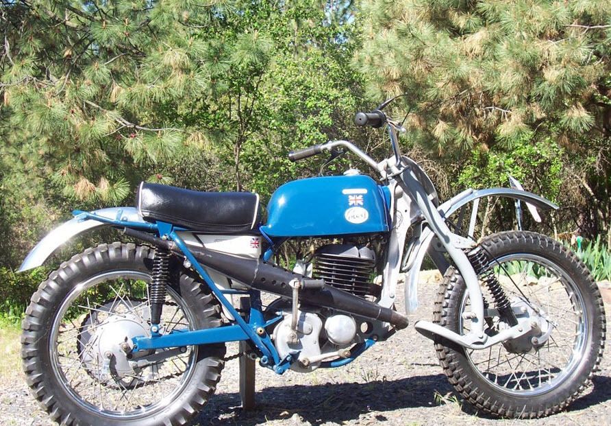

Unless you are into vintage MX...
no need for LL's on a solo bike.  Greeves was one of the last holdouts of LL's, and they changed in maybe mid 60's from LL's to telescopic forks.

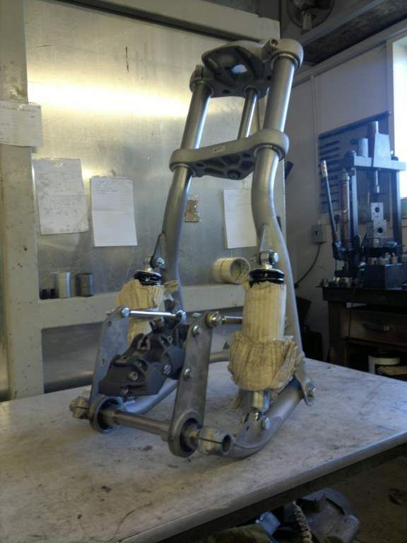

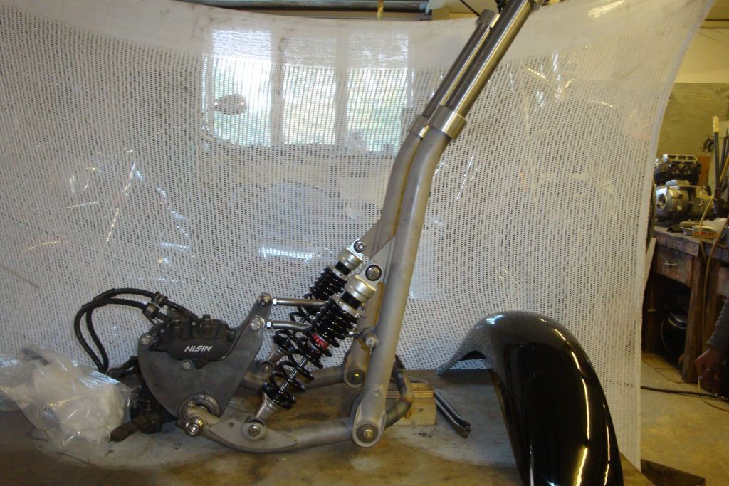

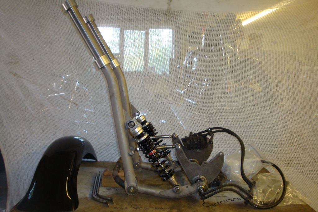

Finally got some Valk Leading Link pics from Wasp.
Mark mentioned these were a bit older, and still have the "straight" swingarm; all their current models have the curved version, like on the XR above.
Since they are building from scratch, this would also be the time to pick up a set of VTX1800 (the same as ST1100 ABS) calipers and them build to that bolt pattern.  Would not cost anything extra to fit the brackets.

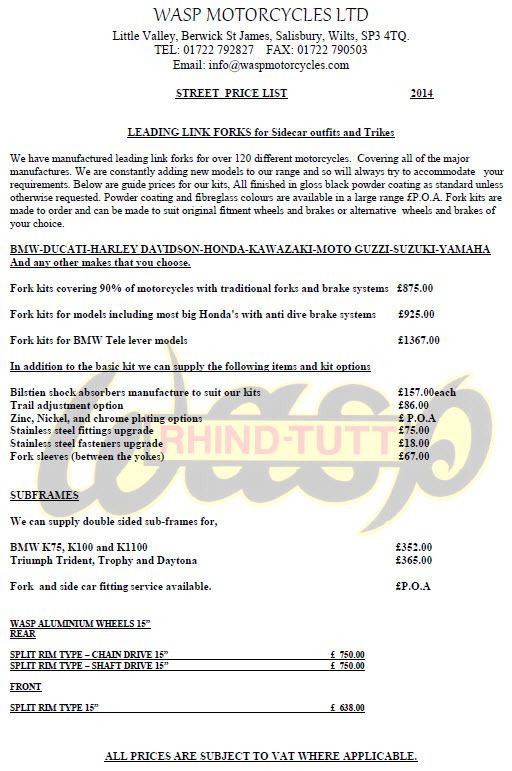

Here is the current price list as well:
I still need to clarify some items for pricing; I'll post back with what I find out.  I am going to gather my ST1100 calipers and get boxed...

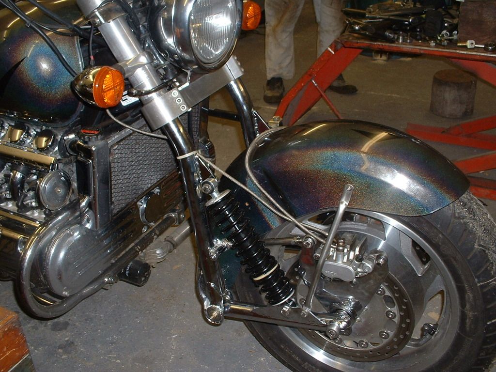

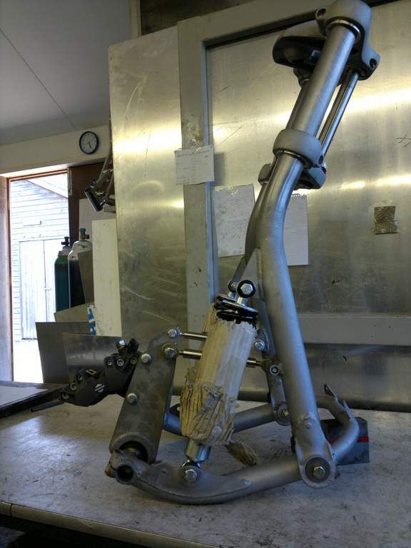

If you are really ambitious, build one. I built this for my trike, this is the fourth one I have fabbed up, steers great, almost like power steering. Also very soft ride. The way the caliper is positioned it tends to raise the front under hard braking, so no diving.

Grumpy - that is an impressive bit of work.  A couple years ago I started laying out the forks for the XR after those guys in Canada (who shall go nameless... Angry) screwed me on my schedule.  I realized rather quickly that my fab skills would be tested in a manner I did not have time for.  The Wasp guys did an outstanding job, with tooling that does not even exist (a mandrel bender) in the town I live...

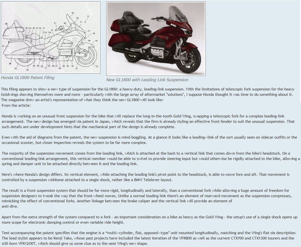

Ok, for the FOUR guys  Wink interested... in the new GL1800 Leading Link... (pinched from the Goldwing Docs forum)
Maybe it will become real, maybe not.  If it does, adaption to a hack would prolly be a bit of effort, what with the telelever strut mods, as well as pricey. It appears to be cast aluminum members as well.  Highly loaded aluminum is tricky to engineer correctly the first time; remember the GL1800 frame debacle?
What I find titillating (love that word  cooldude) is the new, almost svelte looking fairing with what looks like an electric windshield.  That looks a natural to be modded to the new Valks.  The radiator grille looks the same, but with a slightly different cover than then merges with the fairing; which looks a lot smaller than the current GL1800 flavor.   The new Valks are enticing; while the big shoulder look I could get used to, not having ANY type of a fairing is just a deal breaker.  I'm too old to ride sans fairing, as a good part of my daily commute is 80 mph.  And the several trips per year we take all have a good bit of high speed distances.  I think Honda really screwed the pooch by not having any kind of fairing available; and the stock or aftermarket windscreens all look like a$$...
It would appear the new fairing cribs from the ... IMHO, goofy...CTX 1300; which has a fairing about 2/3 scale of the GL1800 IIRC.  CTX 1300 fairing:
Big enough for good wind and most rain protection (like my cut down 2000 IS fairing), but small enough to not feel that you are riding behind the windshield of a Prius...

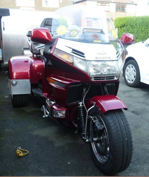

Found this this afternoon.  Seems Wasp has down some GL1800 LL's as well; and with a bit more effort, you can go true darkside on the front! cooldude
Looks like they are using a centerline wheel.  I sent Wasp an email Thursday to advise that I wanted to get this started.  Now I may have to mod it a bit and try to find a Centerline wheel; or something else...  I just did a quick check, and the rear 16" Valk rim with an Austone CT is identical in height to the Valk front wheel with a Dunlop.  Wonder what would be cheaper?  Purchasing a centerline rim and then modding for Valk rotors, or cutting a Valk front wheel hub out and welding to a 16" rear rim?  Hopefully I can get some answers from Wasp early next week.
