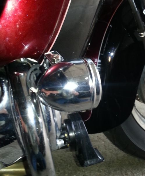

« Reply #9 on: June 18, 2015, 05:31:48 PM »
Here are a couple of pics of the mounting I used. Marcus is right about the LED replacement which I and Mr B did, although the bipin MR16 LED's we used required nothing custom, just plug and play. Be sure to wire in a relay even there is only about a 7-8 watt draw for each bulb, the halogens are very hot with 35-50 watt draw per bulb. The LED's are just barely warm to the touch.
Mounted on the bottom POD screw, remove the POD to install the square bracket. Notice I replace all existing screws and bolts with chrome ones.
Lights lit, they are bright, the pics may do them no justice.
Red Diamond
Posts: 2245
Beaumont, Texas
« Reply #10 on: June 18, 2015, 05:42:16 PM »
Forgot to mention, don't tighten that Pod screw to the point of cracking the Pod plastic. You can find the direct replacement LED at HomeDepot or order them on the Internet, just be sure the discription says 12V. The ones I got from HDepot also says suitable for damp location, no problems so far even in driving rain. The ones on the I/S are 50W Cree equivalents with an 8W draw, I could not find anymore of the 6 LEDs when I installed them on the other 2 bikes. Hope this helps, ride safely.

« Reply #11 on: June 18, 2015, 06:08:30 PM »
Thanks for the pics, I like the simplicity of them.  did you put anything between the mount bracket and the pod plastic or just bolt them on?  I looks like O'Reilly's doesn't carry them any more or at least I can't find them on their website, do you remember the manufacture?
Red Diamond
Posts: 2245
Beaumont, Texas
« Reply #12 on: June 18, 2015, 07:13:14 PM »
If I remember there may have been a square rubber shim between the bracket and the Pod plastic, don't quote me on that but you probably need to install some type of rubber there. If there is an O'rielly near you, it may be better to go to the store. These are the same DL20 lights Rivco was selling for over $100, it has been a while since the install and I don't remember the Manufacturer. I can check locally and get that info for you tomorrow if you would like.

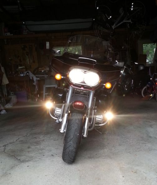

« Reply #26 on: June 26, 2015, 04:43:18 PM »
Picked up the LED's and finished up.
Hopefully they'll be able to see me coming a little better.
I didn't notice if the kit nogrey pointed out to me came with a relay but I figure that I ended up spending about the same or maybe a little more that that kit cost.  I did have all the connectors I needed already but I'm happy with the results, Thanks again Red and Bubbles you guys are great thanks for sharing.
