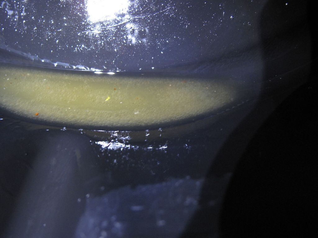

cr@p.
Frickin ethanol.
Had to rebuild the carbs on the Hack, as it sat too long (8 months?) before I could get the hack subframe, electrics, lights, paint, powder, etc all squared away.  This is the bottom of what I pulled from the tank.
 tickedoff tickedoff tickedoff tickedoff tickedoff
Would like to have a friendly chat with the folks who still think this is a good idea... Angry

Sorry to say, but the person you need to talk to will be found in the mirror. 8 mo is WAY too long.
Posts: 13661
« Reply #2 on: July 20, 2015, 04:43:16 AM »
u have to use a stabilizer all of the time with today's fuel.  the ethanol only absorbs water. the gumming/settling etc., is the lower grade petroleum product aka as low octane they can use now due to the ethanol which ups the octane. the LG petro will degrade within 3-4 wks without a stabilizer. I always use a double dose of stabil. Star Tron is just as good as stabil and usually cost less, I just don't see it in my area.
too much ethanol and phase separation can/will occur. Acetone will stop phase separation and is what the methanol racers use.

That will also occur if there is any water in your tank.  The water will pull the ethanol out of suspension.  Sometimes you just have to run it till it quits.  You could also clear that up with Sea Foam or some other fuel additive.  Which coincidentally contain Alcohol.

That is what I found in the bottom of my carbs after sitting 4 months.

It has always been a good maintenance practice to drain a little bit of fuel
from each carburetor float bowl every now and then. Besides it's such an easy thing to do.
So you see what happens when you don't do this!

While I guess I am going to be forced into a fuel stabilizer, I have read that it will only work to keep the ethanol and gasoline mixed; it will not, and cannot prevent water absorption.
