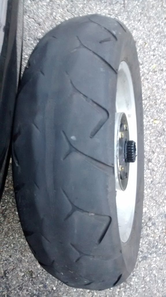

Just FYI
Bought this Valk with 8770 miles this spring with new Bridgestones the PO had installed.  4900 miles and the rear is finished.  I ride solo.  It sure disappeared in a hurry the last week.  Front may last another 2 or 3000.    Avons will go on again next week.  This is my third Valk.    I Always get between 10-12 K miles on the rear.  42 psi in the rear and front
Warren

« Reply #1 on: July 28, 2015, 06:10:56 PM »
Had a similar experience last year with a Bridgestone. Got about 5k out of it Angry

« Reply #2 on: July 28, 2015, 06:20:44 PM »
First concern is why are you riding a mc with at least 12 year old tires, or as much as 18 years?
You didn't post what year bike.
Current train of thought is 5 years. I would go longer, but no matter what my or may not be your problem, buy new tires and move on. See what your next choice of tires give you.

« Reply #3 on: July 28, 2015, 07:01:58 PM »
Longrider:
You may want to try the Metzeler 888 this round. Mine are outlasting and performing better than my previous Avons.

« Reply #4 on: July 28, 2015, 07:30:10 PM »
I only got 7k out of one. I would try to get another 500-1k out of that unless I was going on a trip. (But I'm a cheap bastard). Fronts were better, think I got 11-12 out of them.

« Reply #5 on: July 28, 2015, 08:23:58 PM »
I think he said the PO had installed new tires this spring.  You know they aren't original, as the bike came with Dunlops.

« Reply #6 on: July 28, 2015, 08:57:08 PM »
They were installed new this last March.  I'll be riding it for the next week. .  should have another 800 or 1000 on before the Avons arrive.  It'll be skinny by then

« Reply #7 on: July 29, 2015, 02:01:13 AM »
Do you use the same air pressure gauge when checking your pressure?
Maybe your reading a little high.

« Reply #8 on: July 29, 2015, 06:35:20 AM »
I normally use the one I carry in the bike but I used a different gauge to check it a couple of days ago from my tire changing parts drawer and it read the same as my electronic.  I do change out my own tires with a Harbor freight that I modified. This is one of the cushions I made to secure the rim

« Reply #9 on: July 29, 2015, 04:52:23 PM »
I missed that they where not original, and the statement that the PO changed them out.
How about heat? I know my front tire was worn a LOT quicker than I expected on my drive to Inzane and back. Had that 93' heat in the Columbia Basin, and even all the way to SD was hotter than I liked. I left figuring I had 5K miles left on the front tire, and got back with maybe 300 miles left.

« Reply #10 on: July 29, 2015, 04:59:31 PM »
Gordonv
The heat here most likely contributed to the wear no doubt..  Still,  the Cobras are going on yet this week.

« Reply #12 on: July 29, 2015, 07:31:38 PM »
Warren
Keep a close eye on that tire.  I squeezed a few more miles from this one than I should have.
